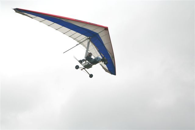

With all the crank talk, the ElectraFlyer was mentioned. Have a look at the web site, and download the two .pdf articles.
Being as technically minded as your average bat, I have lots of questions, but will leave the debate open to Morph and others at first.
A couple of points though
$7500 for the battery. Somewhere it is mentioned endurance 1.5 hours. Battery rated for 300 to 500 cycles = R187.5 per hour and similar to 582 cost at the moment
Seems to be more like a way to get a hangglider in the air?

Gert, the battery must be the expensive bit as the control electronics are actually off the shelf in every town in the country. Variable speed DC motors are simple pieces of kit. Assuming its DC (worked on 7 phase AC yonks ago) I am very interested in the power source, we need to pool resources and dig up more on this very interesting project.

At only 35 Kg i am sure the battery can be enlarged by at least 50%,
giving endurance of three hours.
Then, if you are a weekend flyer, there are always the option of
wind or solar chargers.You can also design the battery bay for easy
interchangeabillity, and have an extra set on charge while you fly.
I would realy like to see the performance figures !!

Cells can be recharged in one hour but since the capacity is so large the controlling factor is the current available from a 110 outlet. Our 110 V charger is 1kw and takes 6 hours to charge the large battery pack. The 220 charger (3kw) can do it in 2 hours. 1.5 hour endurance is the max with a 200 pound pilot, the Stratus wing and no lift to help. A lighter pilot or more efficient wing will increase this figure. There is a power dial on the right lower seat tube which controls the electronic motor speed control. The complete unit including wing, trike, large battery pack and charger is approx. $20K. A detailed price list will be up on the site soon. This is a legal ultralight, part 103 and must be a single seat only. This wing is a slow flyer. The speed range is 25 to 45 mph. When your motor and propeller are almost silent it is most pleasant to fly slow. 50 or 60 mph of wind is loud and would defeat the purpose. No closer pics of batteries right now. We custom build these packs from individual cells for each trike.
Regards, Randall
