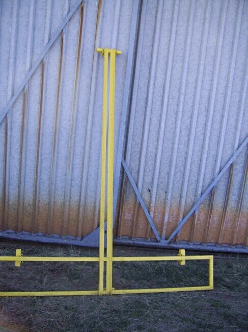

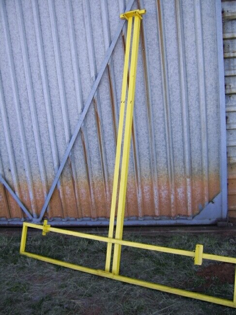

As promised.
Fits exactly on the edges of the cab. Trike wheels sit in the slots provided and gets tied down. Additional struts bolt on for the wing carrier.

Ok, fine.
But how do get the trike onto the bakkie and off again?

Sorry....you need 2 people. Basic indeed. Nobody said it was rocket science or state of the art :D

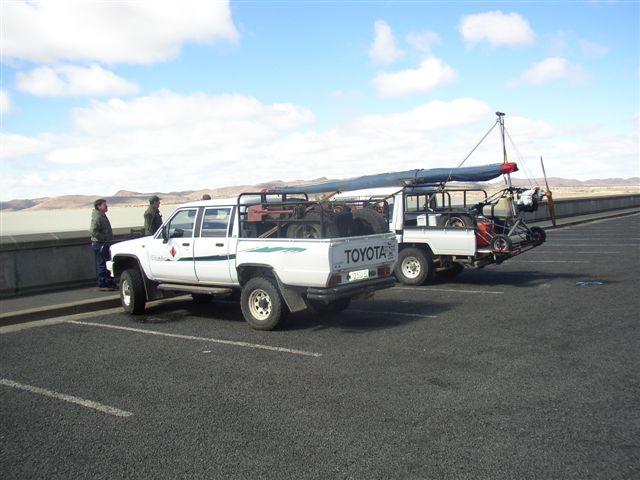

Postby LarryMcG » Tue May 15, 2007 9:43 am
Hi Reza
Have a look at this pic, then maybe give me a call oh 82574610two.
Definitely needs two people, but will depend on the weight / trike you are flying.
Travels very comfortably like this, even over very bad roads. Beware of the height!

Postby nicow » Tue May 15, 2007 10:20 am
Duck Rogers
Nice frame!
I normaly use 2 cars on holiday-1 for the caravan,and one for the microlight.This idea can save me a lot on fuel and toll fee.
How do you tie the front of your frame to the bakkie so that the front of the trike won't lift?

Postby Dre'man » Tue May 15, 2007 11:37 am
Eish, trike on the left as serious landing gear :twisted: :twisted:

Hi Larry,
Looks like a styling mission to me
:!: :D
Is that a landcruiser double cab you have the trike on :?:
Thanks for your number I might give you a call one of these days, its a better deal to use the forum or e-mail as I am in Malawi, much more worth while to chat on the phone when we want to plan a flying mission together :wink: real talk you know 8)
