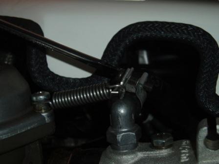

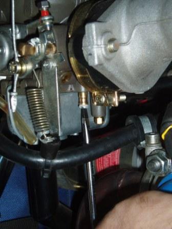

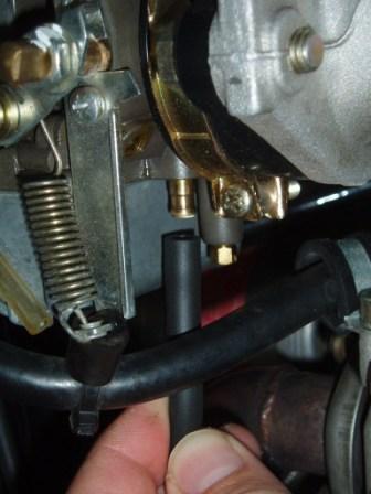

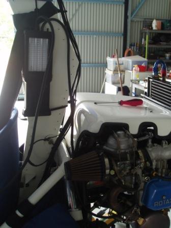

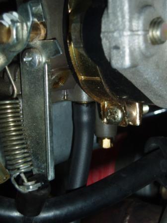

Demon,
Please find photos attached of the use of the use of the new Carbtune. Use the Rotax method of using the nipple under the inlet manifold and plugging the balancing tube.
- Install Balancing Tube.JPG (23.23 KiB) Viewed 1967 times
- Carb Nipple.JPG (25.4 KiB) Viewed 1966 times
- Carbtune Setup.JPG (25.74 KiB) Viewed 1966 times
