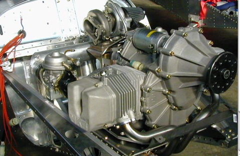

Picture of HKS Turbo
Postby ZULU1 » Tue Oct 17, 2006 9:30 am
After discussing with Robert Gassmann yesterday here is a pic of a half complete HKS 700e turbo, I have had several PMs advising that the factory are producing a unit. Apparently 92 hp ?? but for Gauteng this would be good. HKS are a large turbo manufacturer so they should be able to do it.
My motor has now 150 hrs and is using solo 6 litres an hour, dual 9-10 ltrs per hour, not missed a beat.
eish Zulu1
