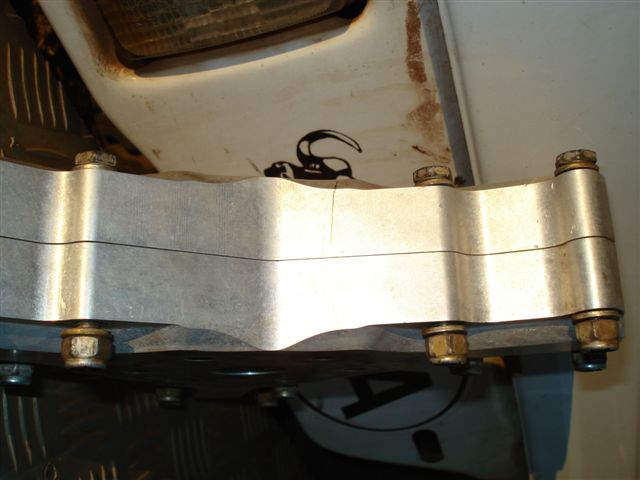

I have seen two warp hubs that came of two Aquillas 582, the hubs both had cracks. After phoning around we heard of one more.
One belongs to Dawie du Toit of Rosslyn Micro flyers it only did 400 hours and the other one to Jacques Burger also from Rosslyn Micro flyers. Hours ???
Can anyone help me on this topic?
Will post some pictures.

Are the round plates that come with the Rotax geabox installed?
I've seen cracks in hubs many years back and Warp Dirve at that time confirmed that this plate must be used, it also states it in the installation instructions.
If I get digital pics, serial number of blades, hours used, etc, I will enquire with Warp Drive.

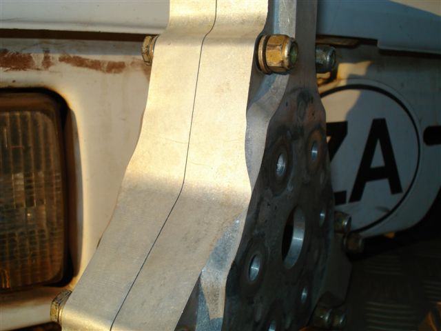

Postby MJ » Mon Oct 09, 2006 2:04 pm
Here is two photos one with only the crack and one with a pencil line next to the crack. This is the most prominent crack but there is a few more. Al the crack is straight thru the aluminum.
Prop did 475 hours on a Aquilla 582 with e-box.
Like to see some pics if someone else also have some.

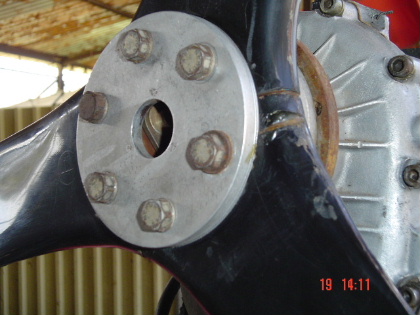

Postby lamercyfly » Mon Oct 09, 2006 5:13 pm
I checked our hub for cracks, but there aren't any. The cracks on my warp-drive is here at the root of one blade:

Postby Leprachaun » Thu Oct 12, 2006 8:55 pm
I have seen cracks on the hub, but in this case no crush plate was used -
Presently I am training with a warp drive ex 503 and now on a 582 .
One of our students lost a helmet through a warp drive a few years ago, Warp is still flying , our cfi HAD A STUDENT ROLL A TRIKE AND THE WARP CUT THE WINGS FLYING WIRES - wARP IS STILL BEING USED - I will probably not recogmend a wooden prop due to the maintanance , sanding , sealing , leading edge repair , oil and moisture saturation balancing as well as tracking.
Fit a composite and read fitting instructions and you will fly for many hours trouble free .
