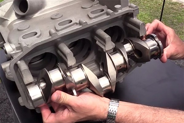

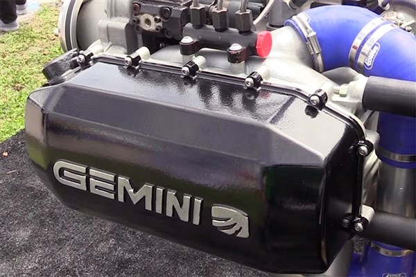

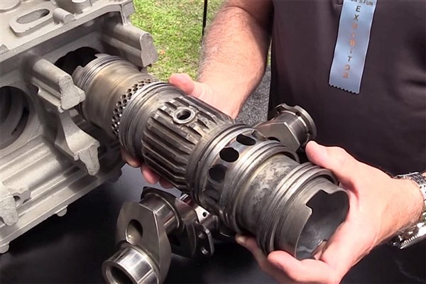

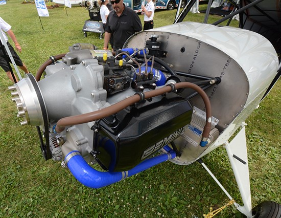

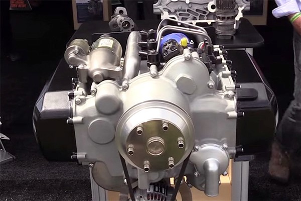

Wow,
This really looks awesome, I would be keen to find out what the performance is like ##
Gemini
The Gemini Diesel is a small horizontally-opposed engine meant as a replacement for the conventional 360 cubic-inch avgas powerplants so prolifically common on the skies. Borrowing design from the historic Jumo 205, the Gemini is a six-cylinder, 12-piston, two-stroke, supercharged or turbocharged engine. These small engines produce between 100 and 125 horsepower, perfect for the light sport aircraft (LSA) community. For those unfamiliar with an engine that has more pistons than cylinders — the Gemini employs two crankshafts on the outer extremes and drive pistons towards each other in the sleeves.
The covering and uncovering of the ports in the sleeves allows for the intake and exhaust of gases. Forced induction has been an optional standard feature on Avgas engines for as long as we have wanted to climb to high altitudes. As the air thins out it needs to be compressed to maintain performance. Forced induction on a two-stroke diesel is not a performance enhancer, it is a necessity. Compression-ignition engines rely on cylinder pressure to ignite diesel fuel, in a two-stroke the compression stroke is joined with the exhaust stroke for considerable overlap.

Old technology.
Was used on ships many years ago. Thousands of shaft hp. The injectors would only squirt diesel in every forth compression stroke because a large amount of diesel would be left unburnt. The next three strokes would eventually do the job. Very interesting
