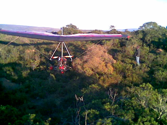

Postby alan » Thu Jul 27, 2006 12:51 pm
Hi All
Just a photo of the trike in the terrain as mentioned. It could have been a lot more interesting :shock:
