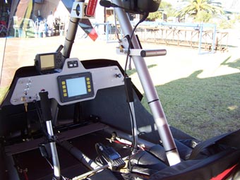

Postby Thunderboy » Fri Jul 21, 2006 10:48 am
here it is on the dash, there is the wing above it though, you can see the little antenna which would be straight up
Thunderbird ZU-ECX

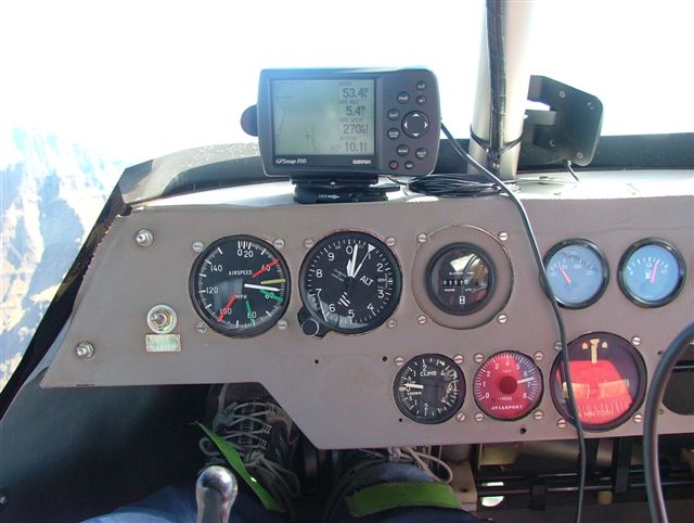

Location: CrossWinds
Postby Thunderboy » Fri Jul 21, 2006 10:57 am
here it is on the dash, there is the wing above it,
Thunderbird ZU-ECX
Postby Morph » Fri Jul 21, 2006 11:00 am
Does the GPS suffer out of the plane in the same cloudy conditions, i.e. away from the wing etc. If so, install the antenna on top of the wing.

Postby IFLYHI » Fri Jul 21, 2006 3:11 pm
After 1 or 2 signal losses I started to use the supplied external antenna on the unit, much better

Postby RV4ker (RIP) » Fri Jul 21, 2006 9:31 pm
Never lost signal in RV since I got it last year 200+hrs. Both KLX135A and Garmin 196 with antenna stuck on canopy. C182 if mounted on Dash tends to loose the signal when bank angle bigger than 45 deg? Position of antenna and solids above it will affect it. (Am told even angled perspex can deflect signal?)
Check the location of the aerial and possibly some ali in they way. External aeries work very well and are well worth it. Have flown in 8/8 cloud (as pax on IF flight) with 196 and had signal all the way - no problem.... :wink:

Postby Thunderboy » Mon Jul 24, 2006 11:57 am
Thanks I have that external antenna that came with it which I'll use if I have any more problems. On saturday I tilted it slightly and I had no problem although there was not much cloud cover either when I was flying.
