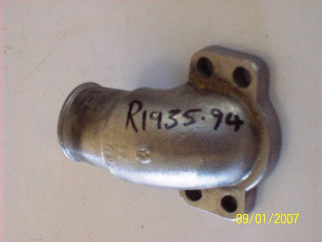

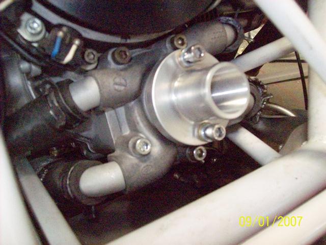

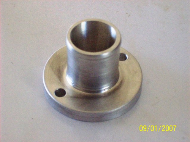

Postby Boet » Sat Nov 30, 2013 8:22 am
The 912 has a lot of "clutter" around it. I always try to "cut some of the clutter" as I belief it will be more reliable. I never liked that stoopid water pump outlet, that turns 90 deg and dives into tight spots wherever you turn it too. The rubber hoses WILL touch something and chafe....... Rotax does not supply a "straight" water pump, so I decided to make my own. Ahh, the convenience of one`s own lathe. Now no more pipes that chafes against anything, or complicated 90 deg rubber hoses. vhpy And as a matter of interest, the 90 deg inlet from Rotax goes for more than R1k. Crazy? :shock: Now do I hear the Rotax guys mumbling and grumbling about us making parts........ :roll:
