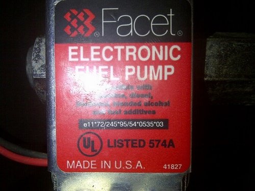

Hi guys,
This has made for interesting reading. I have bought a uncompleted Bushbaby and it came with a facet pump. Stefan at Kitplanes suggested I install the pump. But being new to this I am not sure its the correct type and cant see the 401 numbers you guys all talk about.
below is a pic.
below is a pic.
