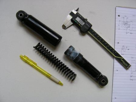

If it is the same item they use on the GT450, they can be rebuilt.

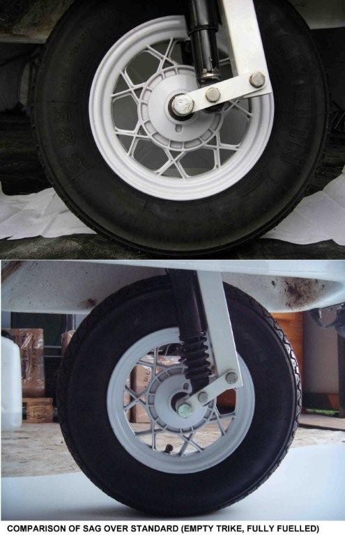

P&M have got the GT and Quik through Section S, but that doesn't mean the front suspension is OK over rough stuff. Mine sagged two thirds of the travel when two on board and full fuel.

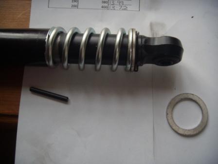

Did a mod (approved in the UK) to upgrade the suspension, and quite a few inspectors and other folk with rough strips followed, 42 aircraft done now. They buy the springs and I do the conversion for free as a hobby job. Owed a few beers at fly-ins...;-)
All you do is trim 19mm off the outer shroud, add an outer spring and reassemble. The outer casing is crimped inwards and hold the shock unit together, and the inner spring is 'screwed' onto pegs in each end. You undo the ends by putting a driver through each end bush and rotating them like undoing a bolt and nut several turns until the ends disconnect with a click.
Use a sharp Stanley boxcutter knife to ream out the alloy crimp in the shroud and they will pull apart for cleaning and regreasing.
Will try and attach the recipe here
Kev Armstrong
UK

Alex is correct, they probably need silicon spray, but the shudder is caused by the brake drum, i have taken plenty to pieces, the drum corrodes on the coast and it does tend to buckle as well. Factory fit the front shocks on a Aquilla are pretty rugged and dont normally sink in service, they are telescopic, what does happen with a heavy landing is the front axle can bend. I think Aiden designed in this as a safety feature. Totally different to a UK machine in design.
