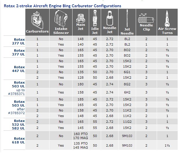

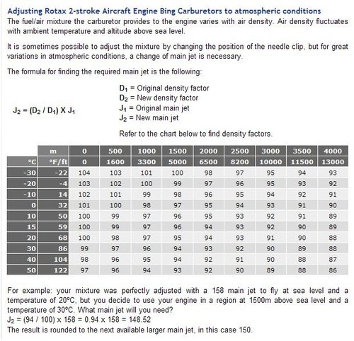

Refer him to the following chart and if he still doesn't want to sign it out then get another AP.
The example given in the chart is for a size 158 at sea level (Rotax 503). Just apply the numbers for the 582 and get the correct answer
Example: I would say 5500' at 25 deg C = 94.5 (D2) and 0' at 25 deg C = 99.5 (D1)
Now D2 divided by D1 = 0.9497 x 165 (main jet at sea level) = 156.70 rounded off to the next higher available main jet = 158
- Duck Rogers
- Posts: 2318
- Location: West Rand
Re: 582 Blue Top Main Jet Size ???
And here's all the jetting and needle sizes for the different Rotax 2 strokes AT SEA LEVEL
