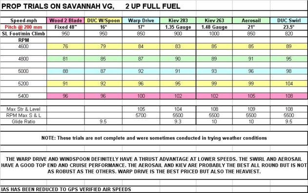

Here some results from our prop trials. Also take a look at John Gilpin's site: http://www.stolspeed.com

Interesting reading.
