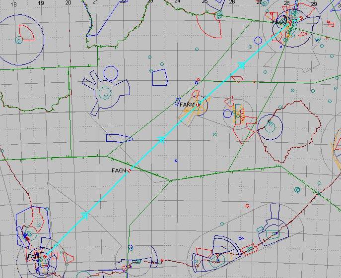

Postby RV4ker (RIP) » Thu Sep 28, 2006 10:40 am
Agent
Sorry only saw it now...
Why not route direct via FAKM, whith stop at Carnovan for Splash & Dash, then to FAKM? FAKM got cheapest fuel in country and nice folks. LAND DEEP else a LOOOONG taxi. More direct line to Rhino and less traffic, so may not have to decend below TMA. Call ahead. ATC only to happy to assist with routings and if they know you comming they only to glad to assist. Go visit the CTRL tower while there.
If go to Bfn, remember to route below TMA and to Soetdoring on way out. the new BFN CTR is incorrect on the maps. Soetdoring is due north Tempe where Bultfontien road crosses the river comming for the Krugersdrift dam. Routing via WMV makes sector reporting easier...
Enjoy it. Go high over the mountains. The winds can be baie K@K low (<1500ft above the ground) over the mountains. Once over the "koppies" there not much to look at. Low level over the free state vlaktes can be bumpy as hell and watch the wind. I had a 30kt headwind last week. Can make fuel planning a bit :shock: ..
POST PICS...
PS
Is this Schalk's new baby?
