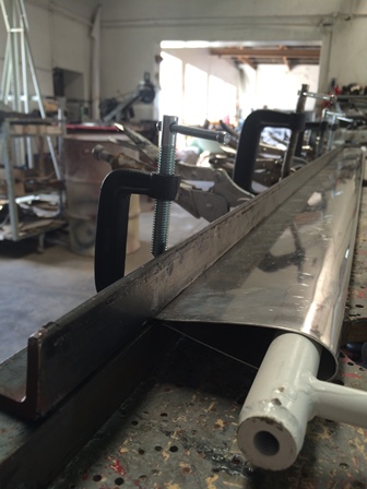

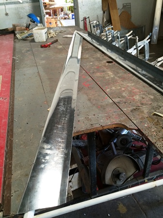

Make them out of sheet aly, fold over sand degrease and glue and clamp, using 25X5 angle iron and LOTS of clamps and vice grips. Not only does it look good, it ads speed!
