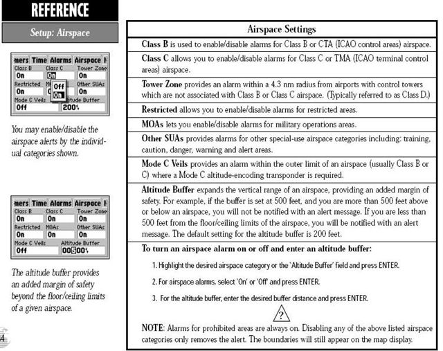

Can anybody tell me how to get the following done.
When I fly, every couple of seconds a message comes on the screen that says " airspace ahead, less than 10 minutes".
Then I must press enter to get it off. What settings do I take off, cause that messages irritates me :twisted:
I can see the airspaces coming on, I dont want to read it too!
I want to know what alarms or whatever I must remove to get rid of these messages. When they are up there, you cannot see anything else on the screen.

Bacchus, when all else fails look at the manual :lol: looks like you want to actually be in airspace section of setup... page 84 of the manual gives a guide to which one you want on or off.
alarms (3).JPG (92.19 KiB) Viewed 827 times
