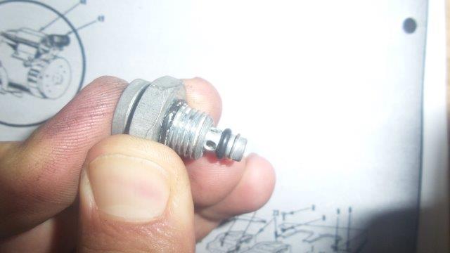

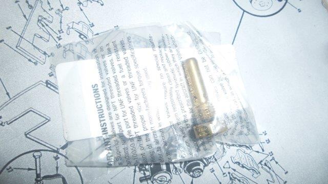

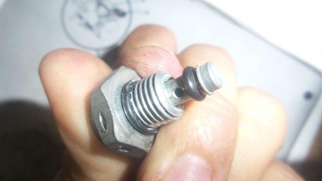

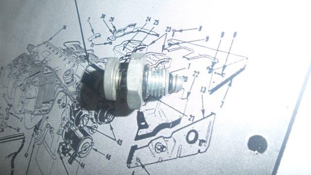

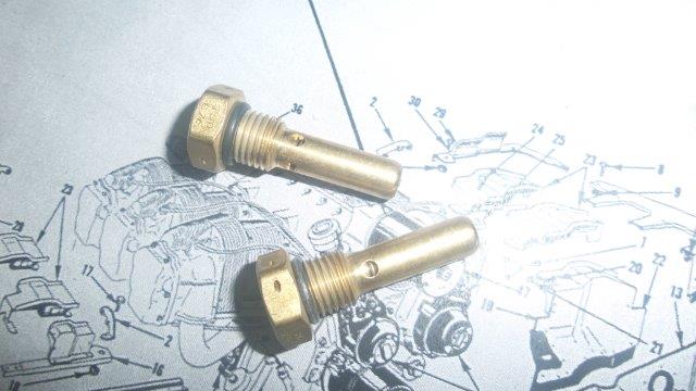

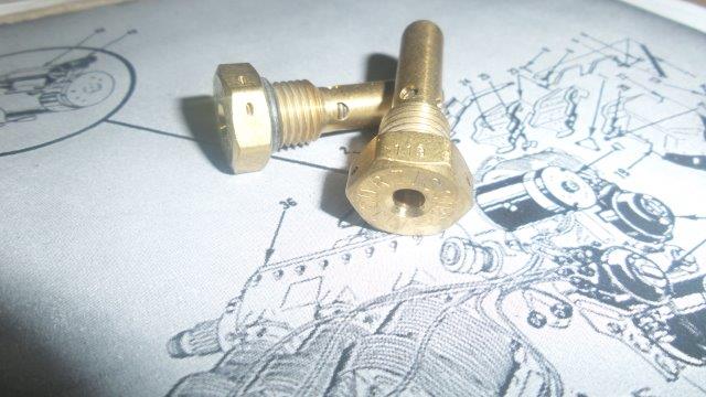

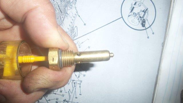

hi all,
thought I would post an update on an upgrade I did to my fuel drains on ZU-DYB - I have had a recent drain seepage problem after replacing and servicing them numerous times. I decided that since I was too scared to check uel before each flight for fear of leacking drains and loosing fuel in flight, I decided to change and upgrade them to Curtis FAA approved Brass units.
The original ones (silver ones in the pics below) operate with a spring and O-ring, where the O-ring is pulled against a sealing face. The problem here is that if the O-ring breaks or dislodges, the entire drain falls apart and you will loose fuel at a RAPID rate (moral of the story - DO NOT PUL OR TWIST YOUR DRAINS) - the newer solid brass units have a tapered machined face and operate internally with small O-rings for a backup. If for any reason the O-rings are worn, or damaged, the two machined angled faces will seal against one another - and the drain cannot come apart - so worst case you might have a drip from the drains, but never a full on failure and fuel pouring out the tanks in flight.
since fitted, not a drop of fuel, and the normal fuel drain is maintained for checking fuel, and you cannot push the drain skew or break it -- etc

Flybynite --
I have a spare set which I ordered for a mate, but seems like he doesn't want them anymore. You welcome to have them - ill show you the invoice, ill give them to you at the same price I paid for them. R386.50 INCL VAT each. I have checked fuel 13 times now since I fitted them, and not a drop leaks out! Problem solved!

Now the question is if they have the same thread as the original one in the tank of an aquilla?
The original looks the same as your old one.

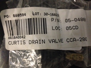

MC Guyver
I don't have any more, and my packaging is thrown away -- flybynite -- please check the Curtis part# on your packaging so we can all benefit from it.

Hi Guys,
Was away the weekend. Will check this evening and post the part no here!

Here it is.........
- Part Number
- Curtiss.JPG (41.11 KiB) Viewed 3913 times
