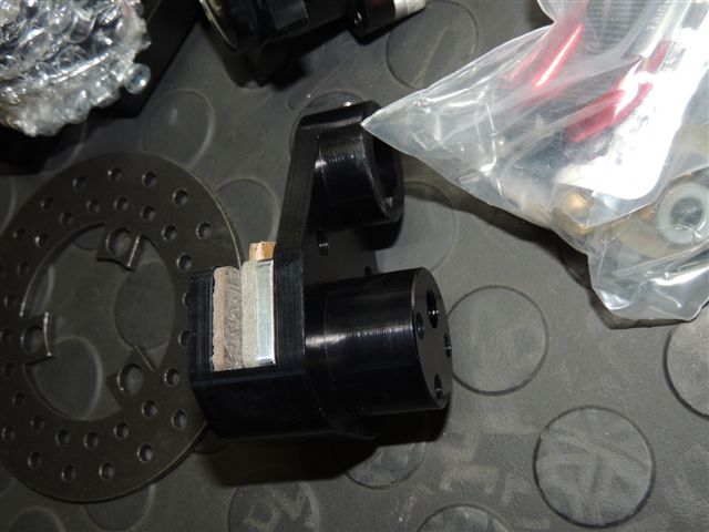

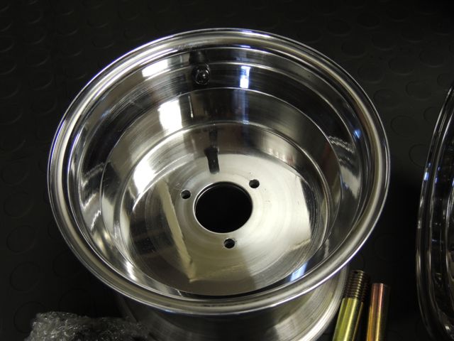

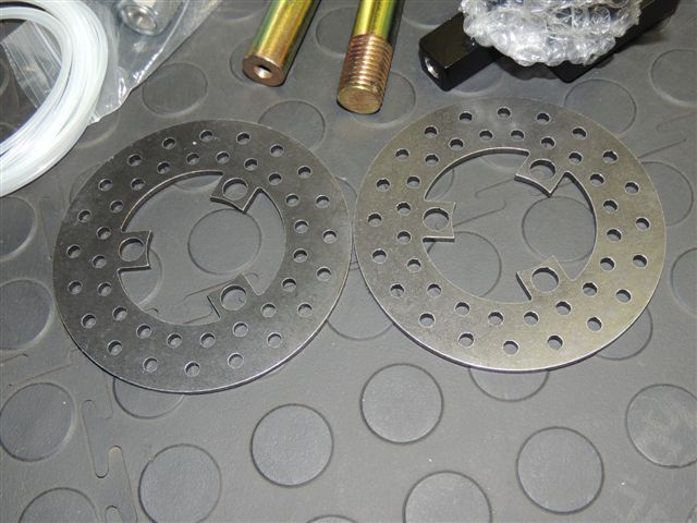

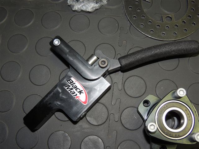

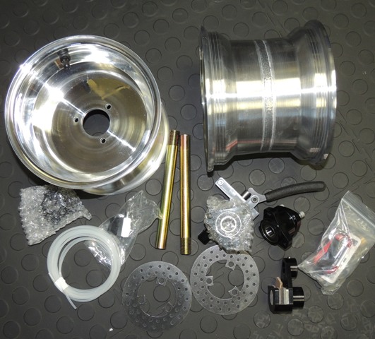

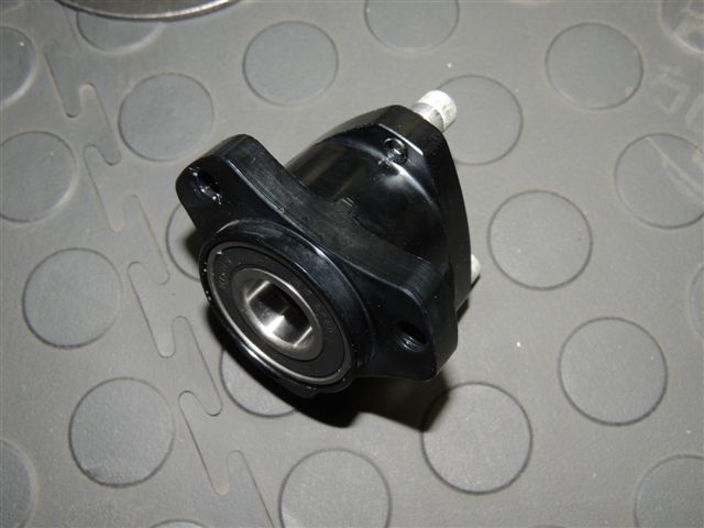

hey all,
Thought i would start a new thread for this - the kit has landed, and instead of brining in just the brake kit, i wanted to get a new set of 8inch wheels with it - i ordered new wheel bearings and hubs, along with two new axles (3 quarter inch in diameter), so a little work to be done, but nothing too difficult. All components made from Aluminium are billet machined, and anodized black.
the only steel parts are the discs themselves and the axles - i also ordered a hand brake valve, which is a small valve you close to apply the hand brake (goodbuy little plastic knob thingy) which is also made of steel with a nice wingnut type valve handle.
Well here it is, a few pics of the kit - top notch stuff, for a great price. Landed here for R8500.00 not bad consdering all the extra (unnecessary??) parts.

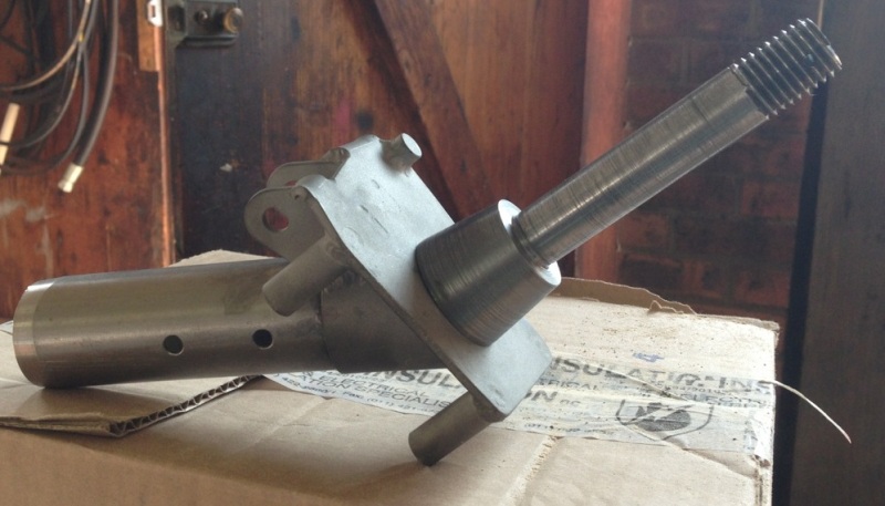

the best thing about these planes is they are (here we go again with that lovely frase) 'home built' - 'experimental' aircraft, anything goes (well almost anything) do it yourself -- here is progress on what i have done to the brake system so far -- let me explain so all who are interested are up to date. (keep in mind, i am using non-standard wheels, which requires alot more work in terms of fitment of the kit - as below)
1) i purchased the left and right knuckles from Mike and they guys -- (expensive frikking thingS!!!!
2) i decided to make new shafts for the knuckles, as the stock shaft was too thin to fit my 3/4 inch bearings (ID size)
3) i cut the stock shafts off the knuckles and left about 30mm for adaption to the new shafts i turned on the lathe.
4) the new shafts are a single piece shaft which will assemble onto the remaining stubs - the first piece is 30mm diameter tapering down to the final 3/4 inch dimater and threaded inside to turn onto the remaining stubs (which i threaded to accept the new shaft) then welded onto the knuckles backing plate.
5) polishing of the shaft will be done before sending for welding
6) lastly this will be sent to a coded welder tomorrow for 'frying up' and inspected thereafter for cracks etc
7) i will probably send the entire unit in for plating (did you know plating can be done in colours, im thinking orange mmmhhh)
Sounds like a hassle, but im doing the job properly and to my liking, luckily i have contacts in the field, so zero cost for the welding and materials used (these are not pieces of off-cuts bought at builders warehouse or the local hardware store!!) for the manufacture thereof.
Mike a comment from an outsider -- it is percieved that you guys dont care -- "perception is reality im afraid" i too run a business, and was faced with the same issue a while back, and there is a solution, listen to your customer and deliver according to their expectations -- simple. Without your customer you have nothing, and its often the smallest customer who makes the biggest noize, be it positive or negative.... I draw your attention to my recent disappointment, which after much bickering Walter came to the party, for which i am thankful -the result -- "problem solved"
Finally, you need to take this one on the chin -- "the message is clear, all of us agree - your brakes suck -- do something about it" a bit harsh i know (apologies)
