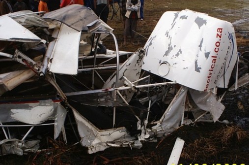

Re: Rans S 10 Sekota
Two pictures showing before and after pictures of my S10. Unfortunately the struts broke in the accident,you can see one of them in the picture.
Thys, thanks for posting this pictures I will post of my project too. I do not like to see the first picture. Did you fly it when it crashed?
All I can say the Rans got a extremely strong fuselage, I read on the internet of a woman who crashed her Rans after 250 hrs luckily
when she went down the one wing get touche by a tree top so she crashed into the ground with the right wing first she and her pax servived
with out a scratch.
Yes, the Rans is very strong. My son and his instructor were lucky to survive. The instructor damaged his back and picked up superficial wounds. My son was saved by the instructor who loosened the harness and pulled him from under the water. He broke his foot and one leg plus a few facial wounds from the windscreen. But all are well now. This happened in 2006.Johnorr wrote:Did you fly it when it crashed?All I can say the Rans got a extremely strong fuselage,

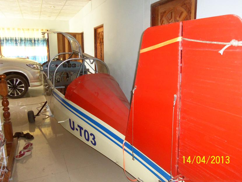

I wash the plane with soap and water and it look so much
better now. Will post more pics when I at home later.

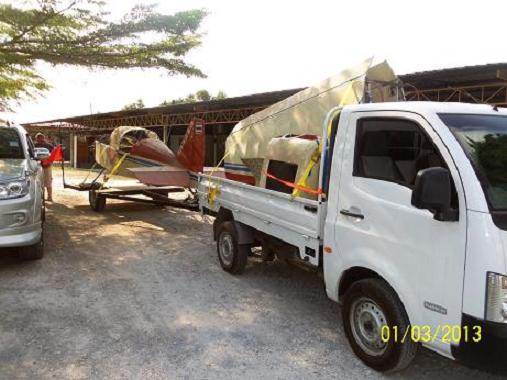

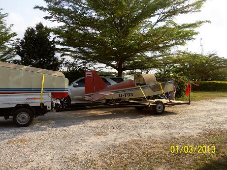

I transport Rans home a long way the beginning of a journey almost 500Kms.

I am happy they survived the crash.Yes, the Rans is very strong. My son and his instructor were lucky to survive.
It was a beautiful airplane.

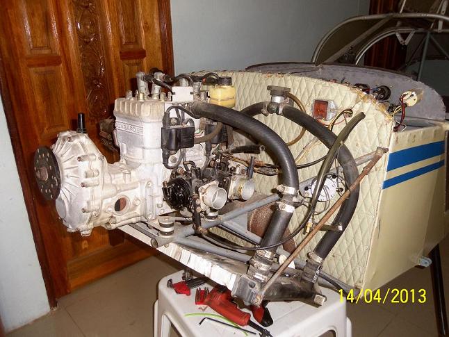

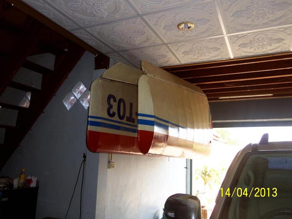

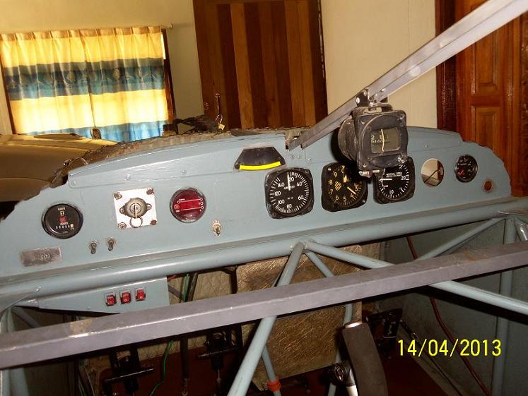

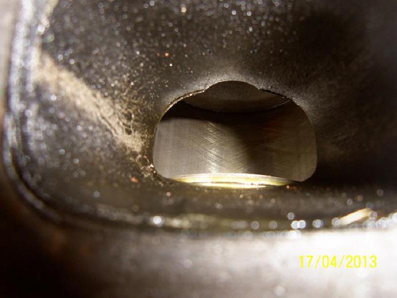

He flew it for 6 minutes and smoke enter the cockpit he land and stored the plane since then till I bought it from him nearly 20 years.
ordered all the parts I need from Rans .Here is a few photos.
