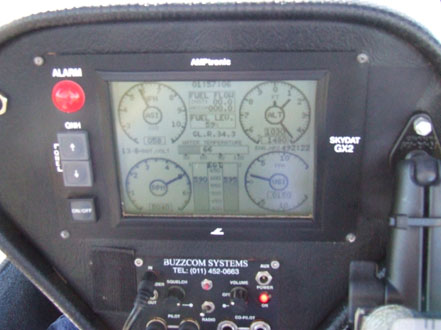

On ZS-WUO I have EGT and CHT gauges. Because the CHT gauge get damaged when it is installed between under the sparkplug, the gauges (when I got the trike) were measuring the temperature on the engin block. Since I wondered whether this would give any warning, I placed on gauge correctly under the plug, and the other on the engin block. The following picture gives the difference - CHT (correct) reads 159 and the (block) reads 46. The difference of about 110Celcius remains almost constant with climbing, and straight and level. So the question is, can one trust the cilinder head temperature to go up in time to warn about impending disaster?

Got DVE back after my "precautionary" landing a month ago.
Now torn between watching the snow on the mountains, and the temp readings on my dash!
