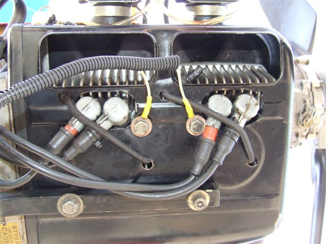

24 May 2008
Sorted out the last of my wiring troubles - I had not connected the MGL Avionics CHT to earth, resulting in a lot of interference with the CHT reading.
My next question is -( see picture) the previous owner had the CHT probes fitted to the enjin block rather than directly to the cilinder heads, ie between the spark plugs and cilinder head. I put the probes between the plugs and CH and promptly damaged them when I replaced the plugs with my 10 thumbs. Now I have new probes, and put them on the enjin block as before (those bolts must be there for a reason), but of course the CHT reading is much less than expected. Is there some sort of "normal" temperature for the CHT probes placed here?
What is better for a 503 - reading the CHTs or EGTs?

Re: ZU-DVE (and ZS-WUO) Flight Log
Hi Gert,
Had a long search for the right picture. Here is an image of one of piston blocks on a 503. It is not 100% correct, but will give the idea.
You can see the fins which is used for cooling the motor on this one clearly. On your picture, they are hidden by the cover that give the engine the correct air flow for the cooling effect. This is why your CHT reading will be a lot less than it should be, is because the bolt is cooled by the air passing through the fins. The problem is that if something goes wrong, and your engine get hotter, more heat will be expelled by the cooling effect, and your cht will not realy give you the correct variation. I will have a look for an alternative position and let you know. The closer to the chamber, the better.
