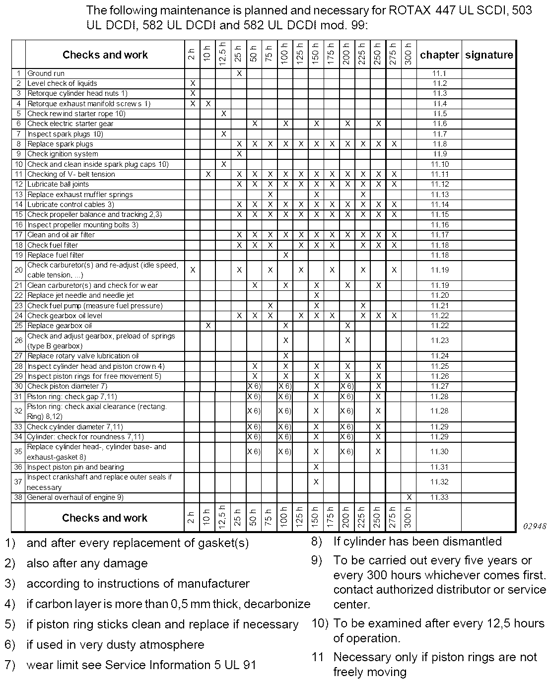

Here's a copy of the maintenance schedule I mentioned earlier
Service Intervals

Looking at the table above wrt service intervals..... we need to get out an approved person every 2 hours of flight time to retourque our cylinder heads and the exhaust manifolds....... doesnt mention what we need to do if our flight is longer than 2 hours in duration, do we land on the road and get an approved person out :evil: ......... mutter mutter mutter :evil:
Are there enough "approved persons" in SA to manage the total number of head re-retorques or plug changes needed on a daily basis??? :evil: hmmm..... watch the prices of "approved person" services and a/p`s go up now! :evil: :evil:

Not quite - the above table is a complete list of every service. It does not specify service intervals, but every service.
So, over the first 25 hours it gets serviced a number of times, but after that, only every 25 hours.

[/quote]It does not specify service intervals
So what does the "2h" stand for? Every 2 hours or at the 2 hour mark and then every 25 hours ie at 2 hours on the hobbs, then 27 hours then 52 hours...... or is it twice every 25 hours :?: ......... actually does it matter seeing as we will be paying "approved persons" plenty money to do all of this servicing over and over again.... mutter mutter mutter :evil:

2h means that the service is performed after the engine has done 2 hours (and never again). (At least not until 2 hours after the 300 hour rebuild.)
Still, requiring an AP to do the work is a bit excessive. Does anybody know if an owner can still become an AP on their own aerie?
