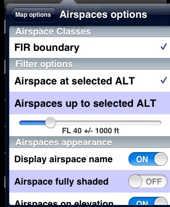

BTW if you want the JHB TMA (JHB Special Rules Area below TMA) which starts at 7600 ft to FL110 to display in ANP you must set the Airsapace Options, Airspaces selected to FL 80 or higer. FL 40, as in the picture below, will not display them.
I am trying to update the Kruger Mapumalanga airsapce as given in the latest AIP using ApenAir. So far I have amanged to create a circular restricted area...wow...!!! Long way to go. I have sent the AIP to ANP support and they said they will update it in the next release.
- Slide to FL 80 or higher.
