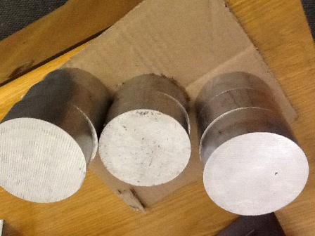

Purchased the 8 billets today and started machining on one already, hopefully have one finished for you tomorrow afternoon. Check in again tomorrow for an update with pics.

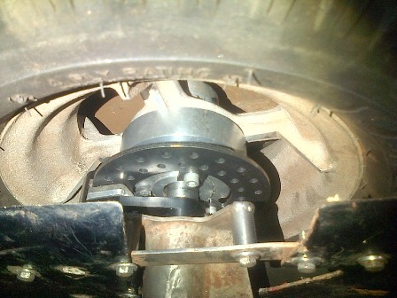

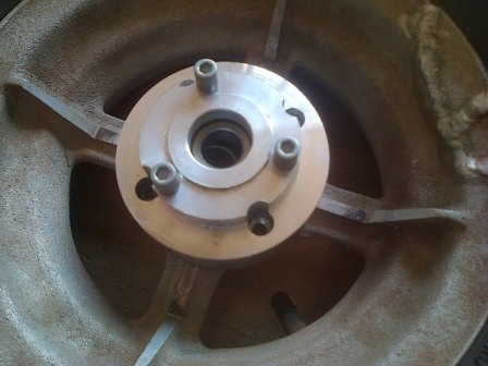

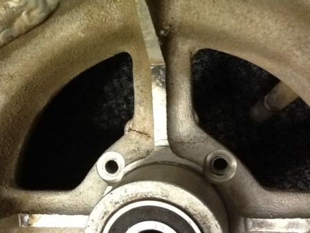

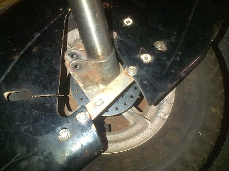

here's an update -- the first set is complete, here are some pics -- spent most of the day on this, with good results! My old tires seems to be very wide, and JUST fit into the spatts - anyways i managed to get these to fit into the Spatts just fine - so normal 4 and 6 play tires shoudl fit much easier than mine.
The kit will include the following:-
1) 2 x calipers with pads and all hydraulic fittings and lines
2) 2 x discs with floating pins and locators
3) machined adapter ring/mount
4) CNC machined Hydraulic Hand Brake lever
4) shaft sleeves to adapt calipers onto the stock shafts
5) All nuts, bolts, washers, and extra bits and bobs
6) work carried out on the knuckles and shafts to accept the brakes -

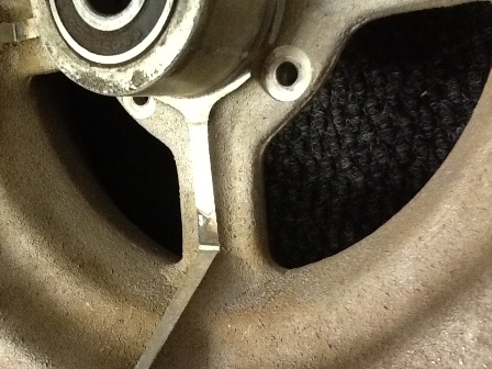

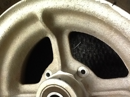

The stock wheels are machined down slightly to accomodate the brake drum, you will see in the pics where this has been done, and where the rims crack because of this (it does weaken the rim some) as the strengthening portion of the rim (gusset) has been machined away... another pic of the unmachined side showing the gusset -- you will clearly see where these rims have cracked - all cheetah owners need to check your rims for cracking (thats why i dont like spatts on a cheetah, cant get to anything!
I know three other people with the same problem. also in the pics is the billet adapters cut down ready for machining.

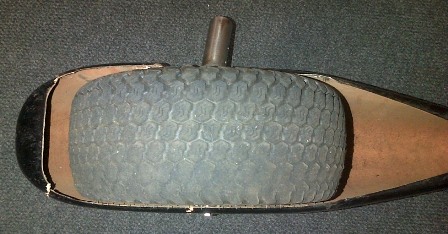

Then upside down spatt with wheel assembly mounted with knuckle, and you will see the caliper inside the spatt - you will need to cut a small 30mm hole into the side of the spatt so that the hydraulic lines can run through it, and give you access to bleed brakes and do the necessary leak checks if and when necessary.

There is a strong possibility that different rims have been used during the production lifetime of the Cheetahs. Over 1000 hours on my Cheetah without tell tale signs. Those cracks possibly from hard landings and too soft tyre pressures, however, a really good thing that all owners check the rims and not just leave it to the AP's.

I checked my rims yesterday as part of the pre flight before my PPL renewal. Absolutely no cracks. My rims are different - I do recall only 3 spokes... will post pics later.

Here you go Turbo... as mentioned 3 holes only and the rims definitely stronger!

Thanks for the pics. This is most definately a different rim altogether, however since I work from billet material, this won't be a problem at all, it might be a different PCD but that is measured, and put into a CNC mill, and cut by computer so it will be perfect. I'm glad this came up. Looks like I will behave to make each one individually, and not just machine all the billets the same.
