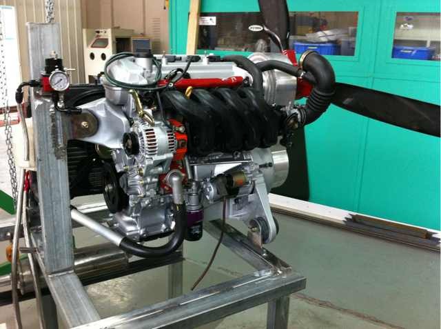

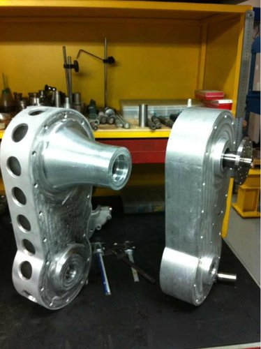

Having been involved for the past 2 years in the development of an aviation engine for light aircraft, I have come to understand the complexities and time involved in a development of this nature. The responsibility you carry as a developer/seller is enormous, as the implications of an engine failure in flight are way more serious than an engine failure in an automotive environment. I do believe Rotax is way overpriced, but due to their dominance in the market, they can charge what they think people will pay, not necessarily what the product is actually worth. And due to the huge worldwide market, and more recently the military use of Rotax motors in drones and other UAV's, their prices are not likely to improve. Added to our weak Rand, as Turbo mentioned above, a new 914 with accessories will cost you €27000, which today is R405000! This price is almost double the cost of many LSA kits out there.
Hence the need for alternative engines. Our development on the Toyota 1NZ block has been slow, and in the end, very expensive. We changed our original bellhousings, and had to make new moulds with engine mounts on either side of the BH, and each mould costs nearly R80000. Then when we developed the original belt drive, we used a system of plates with spacers, but were not happy after several hundred hours of running on a test bed, there was the slightest of movement (I'm talking microns) and we went back to the drawing board. We then decided to cast the redrive casing, instead of bolting plates together, and close the front of the case with a tight fitting cover, into which the propeller shaft and bearings would be housed. (I'll try to attach a couple of photos). This meant more moulds..= $$$, but we couldn't afford the risk of the plates on the original redrive moving over time, and needing constant tightening etc.

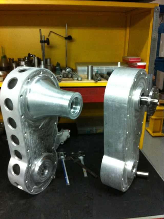

Then once the new redrives were cast, and we had assembled them, on discussion with Boet, he made mention of the fact that the engine face is quite flat/blunt, and that a prop extension would be a wise addition. On discussion with my engineer, he wasn't happy with merely bolting on a prop extension of 120-150mm, as he felt it would place too much pressure on the propeller shaft bearings, so back to the CAD and then to the moulds ($$$$$$$ thanks Boet
), and now we have a 150mm extension on the redrive cover for those builders who want a more streamlined cowling. This kind of development is slow, expensive, and extremely frustrating. Every step of the process must be documented, tested and documented again.
The ECU's are another huge provider of headaches. Aftermarket ECU's don't seem to provide the stability needed in an aircraft setup, and with fuel injected engines, the complexities of fuel/air mixtures, limp modes and other obstacles are a minefield. We have ultimately opted to use the OEM ECU, from Toyota, but using a completely new custom made aviation type wiring harness that will utilise only the engine parameters and drivers. This negates all the other funnies such as motion sensors, door sensors, seatbelt warning sensors and dozens of potential wiring problems. The wires need to be of a specific (not cheap) type to reduce interference with radio etc, in an aviation environment.
We also didn't like the idea of the engine running at 4800rpm in the cruise, as most automotive engines run between 3000 and 3500rpm for most of their lives. SO, back to Toyota...and a different crank, giving us max power now at 4900 rpm instead of 5800 rpm. This allows us to run the engine at cruise at a more suitable 3800-4000rpm, giving us peace of mind that the engine will last longer, but still putting out over 100HP in the cruise. Having said that though, these engines are typical Toyota over-engineered, that even running at 130-140Hp, they are not nearly being worked as hard as they could be. With a small blower on them, I reckon 165-170HP is do-able.
But every step of the process takes time....now it's a different set of bearings for the crank, oversized, to allow the bearings to swim a bit more in the oil...again, we are talking microns...
The OEM flywheel is heavy, 8-9kg's. So to reduce weight, we machined aluminium flywheels, at 4kg's each including a centrifugal clutch to smoothen the engine and prop engagement at lower revs. Sorry sir, minimum order 20....at $1200 each....
and so on and so on.... We weren't happy running the engines on only a light flex plate. In the end, it looks like the engines will weigh approx. 86kg's dry, complete. For 135Hp, not a bad power to weight ratio.
Anyway, it seems we are now finally 100% complete, and will have stock (depending on the shipping delays) by March of my first engines and components. I have made an offer to Stefan at Kitplanes for one engine to test out in a Safari, and stand by that offer. The engines will be supplied new ex Japan, not used and overhauled. I am fitting one into my Savage Bobber demo aircraft, currently being assembled in Italy as a test bed, and this is likely to be the first LSA to fly with the Toyota Skywalker motor.
I wish we could have had this product on the market sooner, but as mentioned, all this takes time. After all, if I am to fly behind my own engine, I better have faith that it's not going to let me down...or else my wife might kill me.
For those of you who have been waiting for months for updates on the engines, my apologies, we are still at it, and should have stock soon.
Anyone interested can give me a call on 082 4590760, or drop me an email at craig@flyingfrontiers.com.

Craig.
Must say it looks pretty good, but also looks rather bulky. Maybe just the picture, but I like it.

Hey Turbo, you had me worried there for a minute..went & checked, actually paid that for 3 moulds, I see. Two BH moulds and the rear engine mount.
Vernon, yes, the engine is much bulkier than a 582 or other engine that many guys fly on trikes. I don't believe it's too bulky or heavy for a trike, as there are quite a large number of trikes flying particularly in Eastern Europe & Russia with heavier Suzuki G13 motors, a very similar 4 cyl engine to the Toyota we are using, just with about 95hp. You'll see what an installation like this looks like on this website www.airtrikes.net
I certainly wouldn't put an engine like this onto any of the older trikes such as a Windlass, and it would be overkill anyway, but the new, faster, heavier trikes would definitely manage. There are some Apollo Monsoons and Delta Jets flying with the Suzuki engines. I investigated this engine some time back, but it was not readily available in SA, and the Toyota engine looked like a better bet, was slightly lighter and had fuel injection.
It's a fairly narrow engine, about 520mm wide, and about 430mm long without bellhousing and redrive. Length with BH and belt drive etc to the prop is about 630mm. The area where some installations may battle a bit with is the depth of the engine, being an upright 4 cyl, at about 600mm. Installed weight should come in around the same as a Lycoming IO233 115hp LSA motor, but at a third of the price or less, and with an extra 20hp.

Boet, we have done two ratios, one being 2.23:1 and the other around the 2.4:1 if I'm not mistaken. The Bobber is pretty much complete, and they will begin the engine install within the next week or 10 days it seems. This may take a little time as it is a new firewall forward setup. I will be going over there (Italy) as soon as they are fairly close to complete, and will hopefully be there for the testing. It's been a long, slow road...but almost there now.Boet wrote:Craig, sorry for the extra $$$ I cost you,![]()
