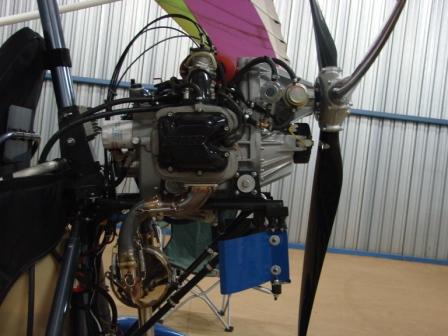

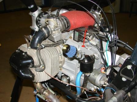

This is in response to Leprechaun asking about the Verner. I have it, and it is fitted onto my Safari. See attached pictures.
I fitted it in May, did a number of test runs on it and got a proving ATF for 20 hrs in July. I have since flown the required 20 hrs, and there is nothing to report. It runs beautifully. Incredible torque, and ultra low fuel burn. Cruises at 4000 rpm, straight and level.
Initially I had some cooling problems on the one cylinder (high CHT) and high oil temperatures.
These have been solved by fitting a scoop over the left cylinder to channel airfow over, and onto the rear of the cylinder, and repositioning the oil cooler.
If anyone wishes to fit one of these engines, please contact me; I've learnt a lot in the process, and I believe this knowledge would apply to fitting a HKS or BMW motorcycle engine too.
TBO? 1000hrs! And the manual does not require a crank replacement when the 1000 hrs are over
Leprechaun, I still have the Aquila engine mount used to fit this engine to your trike available if you are interested.

- Verner Right side.JPG (32.88 KiB) Viewed 1580 times
- Verner left side.JPG (30 KiB) Viewed 1580 times
