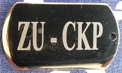

RV12 wrote:We got "nailed" this morning and this is what they found :
1. Verify Contents of first aid kit & Update (old first aid kit)
2. Always Sign LICENSE NO on the flight Folio
3. Always include FUEL UPLIFT on flight folio
4. We need a sticker at the fuel cap that’s says UNLEADED / MOGAS 95 and AVGAS ONLY
5. We need a METAL PLATE in the aerie saying ZU-*** for identification porposes.
6. Replace Compass SWING card to a readable one
7. Keep insurance docs in our aircraft folder
8. Reflective strips required as part of our kit.
Number 5 - had it made on a dogtag yesterday for R100.....
