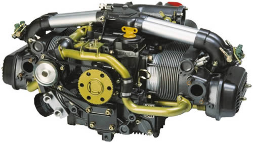

So what about Limbach engines?
Are they reliable?
Are they just un-affordable?
Rotax Alternative & Others

They are based on VW so they are quite heavy. I looked at them a while ago but they are also quite expensive, you might as well go for a Jabiru, better option I think.BAD NAV wrote:So what about Limbach engines?
Are they reliable?
Fly safe,
Rudi
