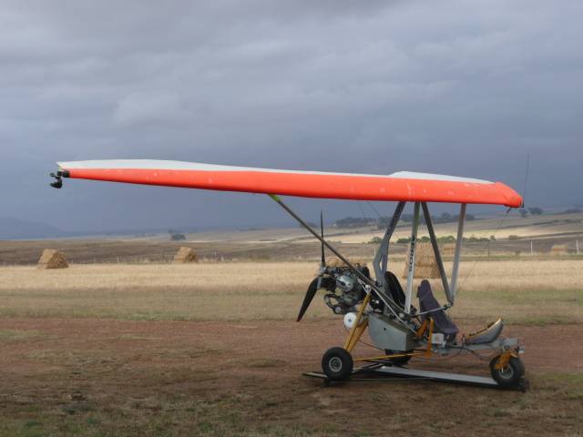

I am all for ALTERNATIVES to ROTAX!
The german website indicates a forward facing 1150 / 1200 motor.
There was SMART applications by the Funks
Is this the installation you are referring to below?
Check the thread "Is this the end of Microlighting?" There I voiced my support to DieselFan & Zulu1....
Dont get me wrong as I indicated in my post....
I investigated changing my 582 installation to a Jab 2200 - and floating at R 150 000 - it scared the hell out of my cheque account! So much so, ABSA decided to cancel my OD?
- bmw_trike_192.jpg (88.53 KiB) Viewed 4008 times

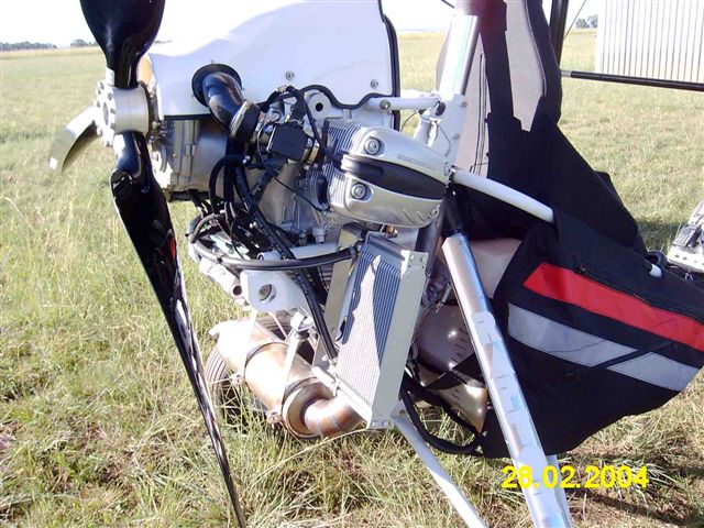

Alex, you really need to talk to Vliegvark re BMW
They have the gearbox, the ignition remapping everything down to a T
viewtopic.php?t=6710

Just make sure it works
My story of BMW powered flight:
My experience flying a BMW powered plane was not that great, but certainly legendary in the Light Flight / Emoyeni area. Gents, I have had a number of things go wrong, least of which was 3 engine outs, one of which almost wrote off both the plane and myself. The motor is a standard boxer design, 85 horsepower, (I think), motor with dual ignition and dual spark, fitted with reduction box. It worked well, looked neat and sounded "to die for".
I bought my Raptor from a chap in JHB that had fitted the BMW because he wanted a 4 stroke. I too do not like 2 strokes and never have. Alan Mackenzie saw the plane advertised in JHB, knew my penchant for BMW and 4 stroke, and made the introduction, then left the negotiations to me. Suffice it to say that I was able to "negotiate" the price and settled on, what I believed was a good deal.
The motor worked well for a while but the problems and experiences, as listed below convinced me that I should swallow my pride, fit a 2 stroke Rotax and be done with it. This I did and never looked back. To the issues:
• It is heavier than a Rotax
• It was dual ignition, but worked off the BMW ignition system, so was reliant on the battery, (not magneto driven, so when the generator packed up it ran on battery for a while then the motor stopped)
• A long stroke motor with push rod valve operation
My feeling was that, because it was the older generation motor, with a long stroke and no overhead cam, it was doomed to fail. You simply cannot expect that type of motor to run at 4 to 5000 rpm continuously. The final straw in the life of the motor was that it dropped a valve over Light Flight airfield. I landed dead stick quite safely, but finally much wiser.
Conclusion: To my mind, the earlier BMW motors are not an option. Following my motor failure I did a lot of homework prior to going Rotax 582. There are a few 4 stroke alternatives, some purpose made for aviation and able to deliver the requisite power to weight ratio. I am quite willing to believe that the new BMW motor with the short stroke overhead cam configuration may well be the answer, I don’t know. If you chaps are going to look at alternatives though I believe you should be approaching the manufacturers / agents and ask for them to do the trials under controlled conditions. Do your comparisons and draw your conclusions, or look at what overseas is doing, particularly the areas that are phasing out 2 strokes. Trials and testing costs a lot of money. Even if you find that "perfect" motor, it may not be the best alternative

Is the above photo your trike before engine replacement?
On the Bmw motors
On the theme of the BMW motors there are thing one can do and thing one can't do
all old motor are out , that is a they say the airheads the newer oil heads they way to go
reason is short stroke , oil cooling , weight alot better ( R1200 engine are the best)
then one must make the oil cooler bigger and have more than one oil temp to make sure the motor is cooling that is a +-20c lose after cooler
then I believe one must run two computer boxes so you can't just take the motor off the bike and stick it in your plane one must change it to do the job.
I believe in these R1200 motors so much so that I am buying motor were i can i believe in these motor because i fly one and it ROCKS
mytrike has 60 hr on a R1200GS motor and my dad has 200hr on a R1100S motor both trike
the key to a engine is one must be happy with it and safe
and never foget any machine has feeling so talk to her and give her a kiss if she took you were you wanted to go and if she brought you back
there a lots of good engines to fly with I just happen to have a super BMW engine
