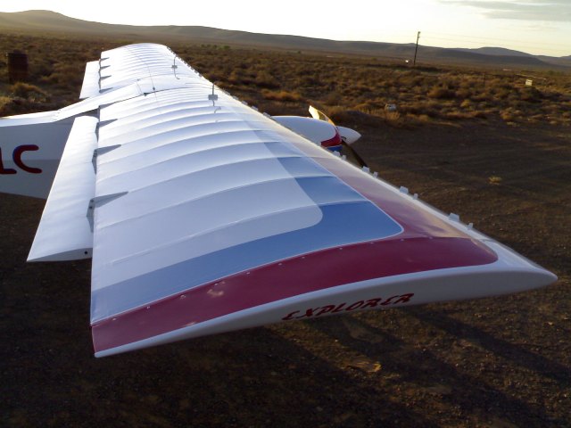

The main reason I prefer the 2K route is COST. And labour. You can get away with a lot less material when spraying Polu-U. Same is also a lot more glossy than Pigmented butyrate dope. Pigmented butyrate can also be shiny, BUT entails LOTS of elbow grease. When spraying Butyrate, you will need at least 5 - 6 coats. With Poly-U only 2. Belief me. :D
2 coat gloss.jpg (53.61 KiB) Viewed 890 times
