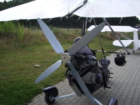

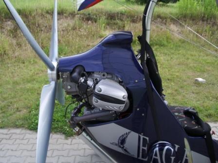

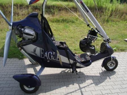

BMW Engine On Air Creation
Hi Guys,
I have been looking at a nice coversion by Mister Chapelet on a GTE AC trike. Have a look at the pictures on my webiste.
http://www.flylight.eu/v1/2007/03/30/ai ... mw-engine/
The owner has taken it over Mont Blanc at 16K Ft and was having plenty of power left. I did the same with my 912 but nothing left, it was the max it would go.
I personally wouldn't hesitate to convert a two stroke trike in to a BWM four stroke. But......you must know what you are doing or ask a guy like Aardvark or Mr. Chapelet in France.
