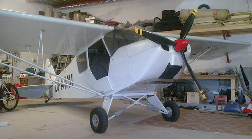

thanks for the reply. Mine is ZU-AWM. Airframe is zero hours and has a 582 installed. I am busy with the weight and balance and I noticed that the aircraft seems longer and has a longer wing cord than mentioned in Fisher's flight manual. It also hasn't flaps.
I want to find out if we had a locally produced version that were much different, as I need the correct data for weight and balance.
Attached is a photo of her currently...

Not supposed to have flaps...........maybe someone "modified" theirs to have flaps but none were built locally with flaps.
I notice the little window behind the doors are not half-round like all the locally made ones.
I wasn't aware that the fuselage was longer. Perhaps because of the undercarriage interchangeability like I mentioned. How much longer...about 75mm? That will also take care of the wing chord then.
