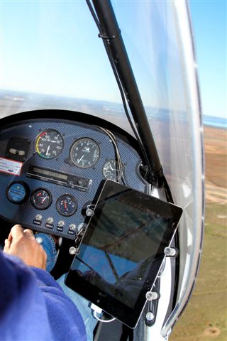

Postby salem » Mon Feb 23, 2015 11:25 pm
Flying my Challenger in Saldanha with Air Nav Pro. Best investment I ever made.

Postby mulderpm » Tue Mar 03, 2015 1:28 pm
salem wrote:Flying my Challenger in Saldanha with Air Nav Pro. Best investment I ever made.
I agree. It is brilliant. In an open cockpit, where paper is out ,and fiddling with buttons through menues to build a new flight plan is dangerous, ANP is just the answer. Tap and go (^^) (^^) (^^)
