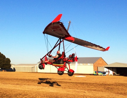

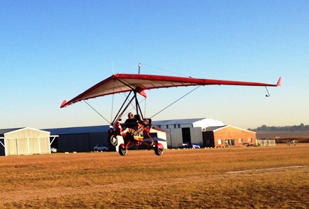

The first Aquilla with winglets in the country took off from Petit Airfield today!
aquilla winglets1.jpg (51.66 KiB) Viewed 2934 times
aquilla winglets2.jpg (55.96 KiB) Viewed 2934 times
Jenya, Aerossa-wings.

Eish Jenya......marketing your product is one thing BUT are you not compromising the pilot here if the issue is not resolved (or at least clear)....?
Raptor 582

Postby Jenya » Sat May 31, 2014 9:49 pm
AWACS wrote:Eish Jenya......marketing your product is one thing BUT are you not compromising the pilot here if the issue is not resolved (or at least clear)....?
Theunis, after winglets installation done by me, this aircraft has been checked and signed by Andy Kaspersen as AP, test flown by me as test pilot and the minor changes have been submitted into the aircraft logbook.
BTW, the aircarft flies absolutely beautiful.
The stability has been really improved.
