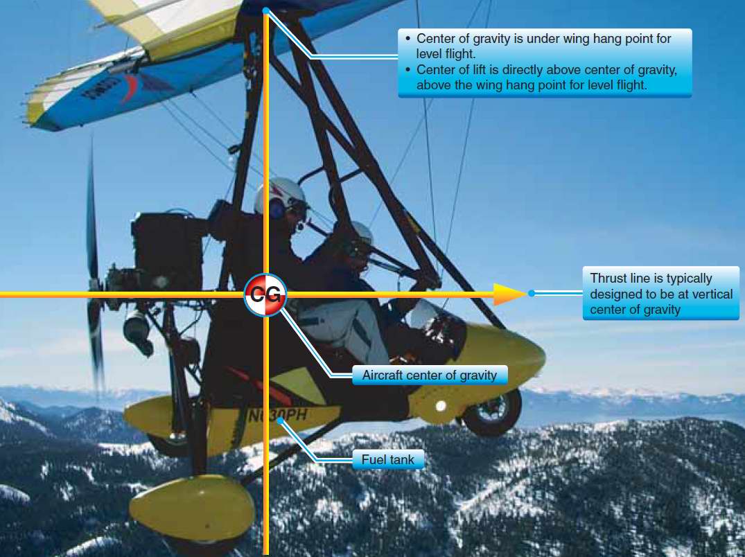

From the "Flight Manuals" the CoG of a two seat weight shift control Trike is typically slightly behind the pilot seat in the middle of the passenger seat. Therefore the CoG will not significantly change with a passenger. It is also directly above the middle of the fuel tank so that different fuel quantities do not significantly change the CoG fore and aft. Furthermore, it is in line with the thrust line of the engine. An imaginary line drawn from the centre of the prop through the middle of the crankshaft.
In level flight, thrust, drag, lift and weight are all balanced therefore, the CoG will be directly under the hang point and on the thrust line.
Now you, weighing about 80 Kg sitting in front of the CoG, bails out. Considering the cart weighs about 3/4 of the total aircraft weight, thus 150 kg of a 200 kg Trike and you weigh 80 kg giving the cart a total weight of 230 Kg. Lets leave the passenger at home, in any case she does not weigh much. With this weight in the cart the CoG is as described above. Now you bail out. The front (in front of the CoG) of the cart becomes 35% lighter (80 Kg's) lighter. It should pitch up quite violently...like pushing out the bar? OK, the engine is dead and you are gliding so all the forces are not balanced, but still, the nose should pitch up significantly....maybe even resulting in a stall?
