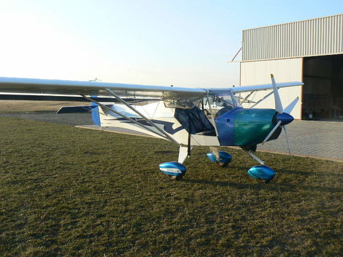

Mine is not quite a Bushbaby but an Apollo Fox cousin, driven by a Subaru EA71.

cosmin nice prop, what is it?

Postby cosmin » Thu Jul 25, 2013 7:46 am
Very light composite blades and hub made by th plane's manufacturers, Halley Kft.
The prop is driven through a standard Rotax 582 gearbox.
Here is a picture of a similar installation:
