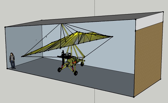

This is probably the most cost effective design. The advantage is you save on engineering the massive doors, as it's a much simpler side door arrangement (as shown on the right end)
The disadvantage is you will have to put your trike on a dolly track to load it in sideways.
Framework can be either wood pole or steel.
Corrugated iron roof
Shade cloth sides and door.
May even be more cost effective to build out of cinder blocks.

Just remeber with corrugated sheets needs more slope than IBR sheets for snow or water!Like the design Hoke!I want to build one like this on the farm!3.5 * 12.5m. (^^)
