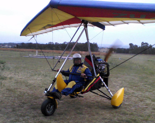

In the mean while I have purchaced a trike. It is a Raptor serial no 007 so one of the first with only 260hrs on. Under Flo's watchful eye the trike was stripped and completely rebuilt incl new shortblock 582. Last week Flo took it for its maiden flight and all is well. I have attached the GPS data and a cell phone foto.
One thing that has perplexed us is the prop. We have tried two 72x50 de necker props and on both getting 6700 rpm static which is high. The rpm was confirmed with a optical prop rev counter. So we fitted a 618 prop 76x50 and pulling 6450 rpm static. As soon as the weather clears we will test this combo. I have another electronic rev counter which I will also attached to reconfirm the rpm. If rpm is true this is a nice motor. Any ideas on props welcome.

BTW.....if that's the correct rpm on the new prop, then it seems to be the correct prop

Hi Duck yip the rpm is correct, when we flew it the prop did not unload and the rpm only went up by 50rpm to 6500 - so still not 100%. I don't know if the low qnh of late has anything to do with it. The fuel flow meter says 8.4l/h @ 50mph 5070rpm. I like to also try a higher pitched prop just to see.

Tailspin yes Pieter made me a 76x50 and I am flying it at the moment. +-6600 static and 6750 in the air. You right the length has me worried but so far no nicks on the prop.
