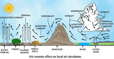

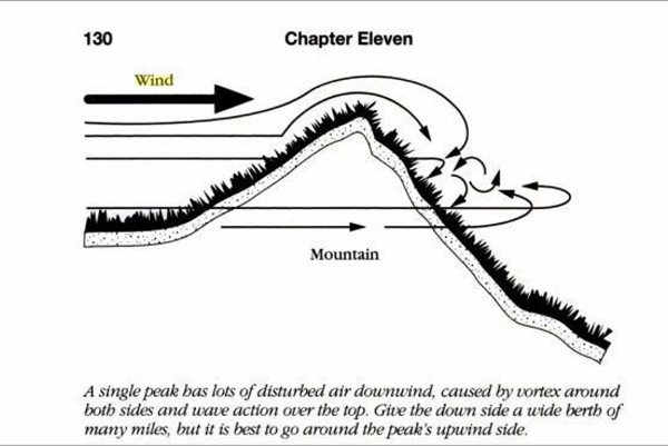

Postby Tumbleweed » Tue Feb 08, 2011 2:44 pm
I'm certainly no expert but I would remain cautious about enough height if the wind is coming off the mountains. Imagine the air being water and the obvious skommel as it flows over the other side.
AS you approach that turbulance it's going to suddenly suck you down without much warning.
Read more on mountain turbulance, sufficient height clearance and flying on the leeside.

Re: safe flying
Postby Ranger » Tue Feb 08, 2011 4:52 pm
Hi. Some of us who regularly fly over the Western Cape mountain ranges have gained a bit of experience in some or other way and in my case the hard way having connected mother earth after flying into a mountain rotor. A basic rule of thumb is to cross a mountain at least 1 and a half times the height of the highest peak in the area and to remember that rotors caused by strong winds can upset your day even far away from the mountain. Approach the moutain at 45 degrees which will give you room to turn away and climb to a higher altitude to try again if a downdraught is felt. Downdraughts on the lee side of the mountain can be as much as 3000 ft/m and no microlight will outclimb that. If you are lucky to make it into groung effect in one piece that is where it will keep you and with no fences or obstacles in your way you can try fly away. If there are no fences or obstacles you might as well land. In a valley stick to the windward side of a mountain. There will be some lift there. As for landing in bush and trees there is no correct way. Try and aim btween two trees or bushes sothat the aircraft takes the impact and breaks your speed. Only birds can stall and land in trees not microlights. That will kill you and is less controlled than aiming to land between trees. Fly the aircraft into the crash until it stops. This is what i would do and if it doesn't work for you or you disagree don't shoot me. Look at this site http://www.experimentalaircraft.info/fl ... ying-3.php . Th
