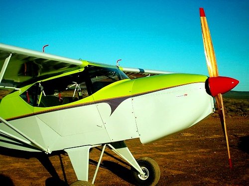

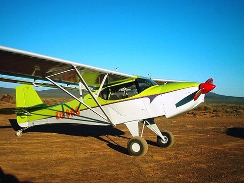

Try to get a hold of an old Bushbaby airframe. Pre no 20, they fly really nice with a 503. I had a 3.47:1 E gearbox in it, and a 70X50 P-Prop. mostly a single seater up high, but at the coast 2-up was not a problem. BTW, This one was done, just because everyone told me it can`t be done!!
