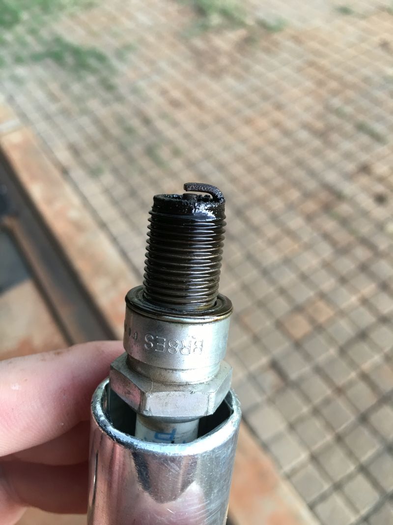

Hi guys,
today I changed my spark plugs on my Rotax 503.
There is some "petrol and 2-stroke oil" left.
engine hours: 669.5 hours
last change of plugs: 47 hours according to logbook
Mixture is okay: 20L & 500ml Oil (Engen Super Outboard TC-W3)
EGT 510-540 deg.
CGT not fitted
Normally the plugs should be dry and brown from my understanding.
The rotax is build-in the upside down configuration (windlass 503). Can this cause the build-up?
Any ideas? Till now there was no anomaly in regards of power & reliability...
cheers swartkat
