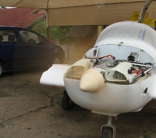

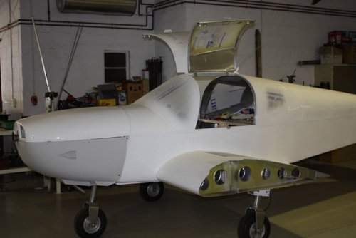

This is the Raven we are busy completing. (yes, its the one bought from James)
It has the Jabiru 2200 (85hp) motor installed and we are planning on using the Jabiru 60x42 prop.
We've added an additional fuel outlet from the 65L tank (in case the current one might get a blockage). Also installed an extra electric fuelpump on the new line.
Dirk went into a loooong sorting out phase with all the wiring of instruments - but now everything is working
We had the front cowling sprayed to match the existing color....but as luck would have it....the guy didnt get the color right.......A beautiful off white color....but just not matching the rest of the plane! (we'll look into finishing the paint job just after test flights)

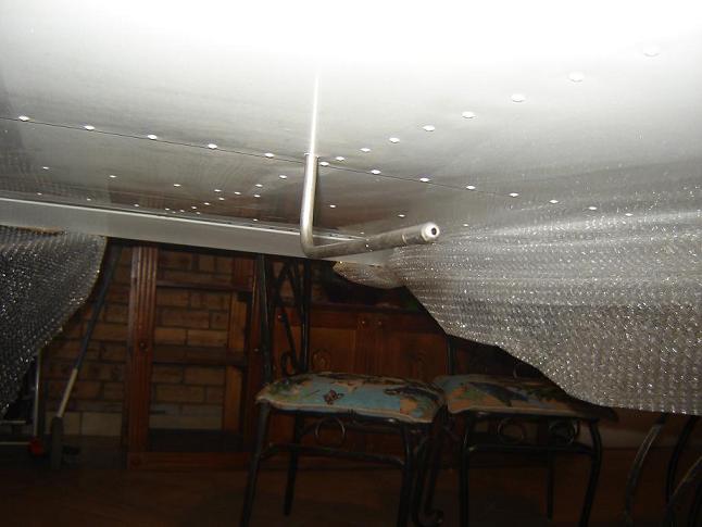

We got the Pitot and it was installed in the left wing.

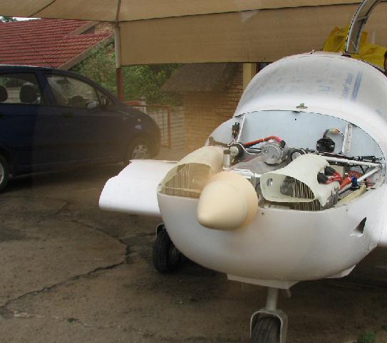

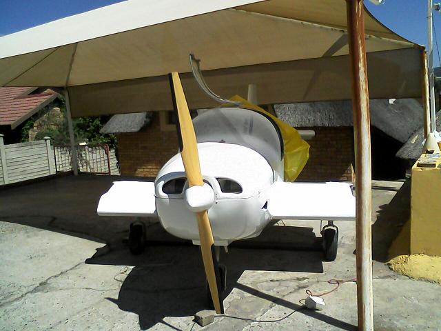

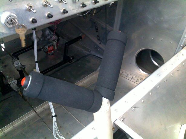

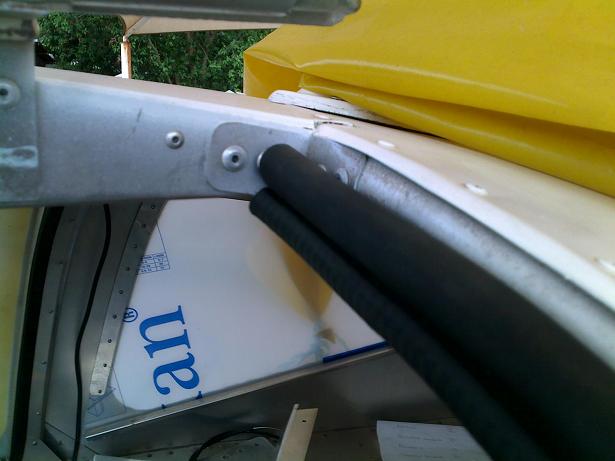

StickGrips and PTT's The door seals.....we are still battling with the seals at the rear end of the doors. Door won't close nicely with them installed...anyone with another suggestion on what we can use for the doorseals?

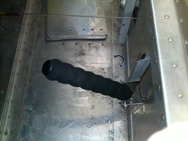

Brake lever and grip:

Prop is also installed.....It is the Jabiru 60x42 prop. We have a ground clearence of 9 inches....according to Jabiru guys the minimum requirement is 4 inches....so we are well in the green.. Really looking forward now! Hopefully another month or so....and we'll be there!!!

You might go and visit pro-aout rubber for some ideas on door seals. http://www.proautorubber.co.za/

Try rubber extrusion co's or have a refrigeration mechanic sourse some soft 'D' door rubbers.

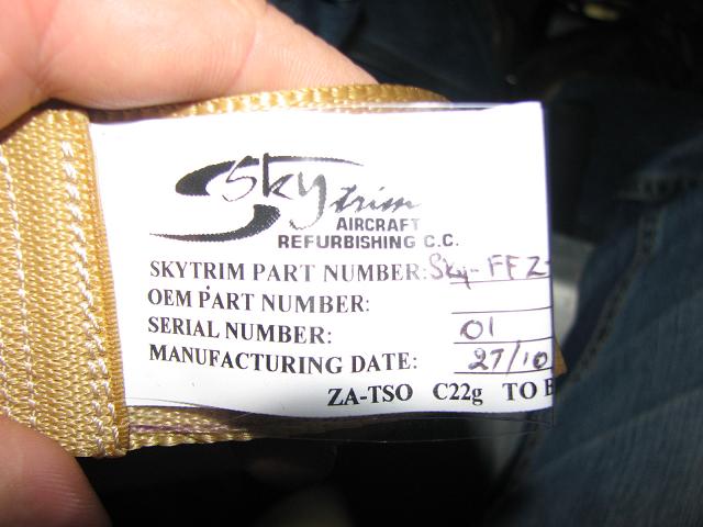

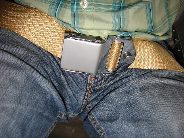

Well, the new registration number also allowed us to get the safetybelts done........here they are...CAA approved safety belts : (at a price of course...but they came with all the test certificates etc etc. )
I am quite happy...!! Here they are as it'll be in the aerie:

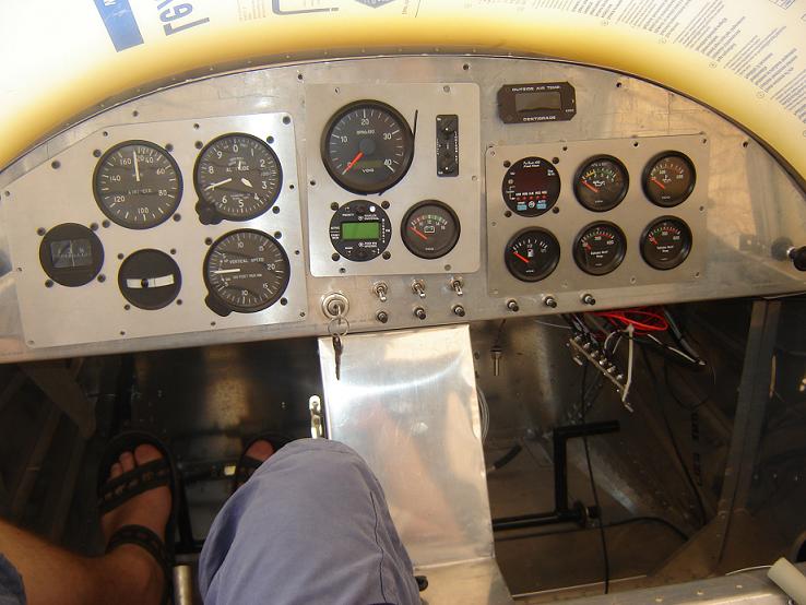

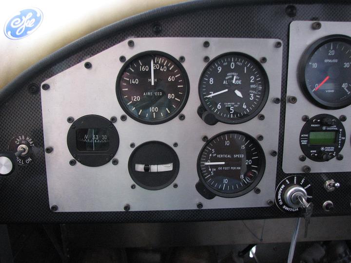

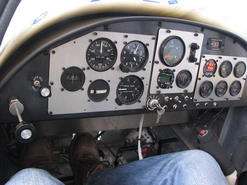

And then we got the Panel sorted out.....We thought of spraying it a light color.....but at the end settled on the carbon fibre look....and I like it!!
Here is the bigger picture:
I can't wait to see these little instruments at 8000 ft

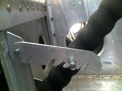

c. Would like to put some kind of a manual lock mechanism on the brake lever, as to be able to use it as a "hand brake" as well.

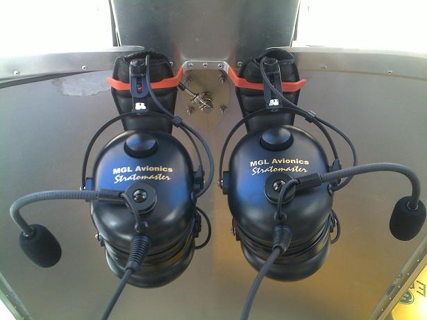

I've found the piece of alliminium I was looking for....so I could at last make the headsets storage plate. Used some heatshrink on the tips to protect the headsets from the metal when hanging them.

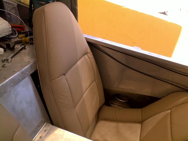

Then our seats are coming along....they were made beautifully...although a little too thick at the back...a little thinner and the sitting position will be real comfortable.....
Then one of my "pet projects" on this plane.....I wanted to be able to lock the brakes in position.....for when you are parked somewhere....and even on start up when doing checks etc. So here it is....works pretty well....the lockplate are able to hang straight down out of the way if not in operation.

Hi Dirk/Martyn, the aircraft is looking good....you must be itching to fly! Where did you get the seats done?
Re: Dirk & Martyn's RAVEN (2200 Jabiru): ZU-FFZ
Hi Scotsman....
The seats were done by a guy here in Rustenburg. They do car seats mainly, but have done seats for one or two of the Rustenburg homebuild aircrafts.
Unfortunately, with the seating position of the RAVEN ...you will want to make the backrest as thin as possible...that will allow maximum comfort at the end. So we'll have to get them a little thinner, But the basic look will stay!
It was/is quite difficult to get the guys to finish the seats(and other interior covering) as the aircraft can't be taken to their premises. And if the aircraft is not there to remind them about it....they tend to forget to continue But the new deadline is for Saturday.
We haven't receive the final bill for the seats....but it is NOT really going to be less expensive than the professionals at RandAirport or Wonderboom. Only thing is...we were in a catch 22.....Need seats to be able to do proving flights,to then be able to fly plane to wonderboom/rand....Rand/Wonderboom need to provide the seats??......so we've settled on the guys in Rustenburg. .....and except for the wait...they did good work.
