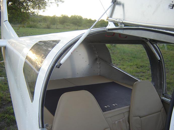

The INTERIOR was finished....and we are more than happy with the outcome.
Then the GAS STRUTS was also installed..no more "bloudraad" solution!.....
It was a mission to get the "non pumped" struts...and then also the fittings. Gas strusts was bought from Diesel Electric and the fittings as well.....but I had to drive to Diesel Electric's head office in JHB to get them..... (surely i could have ordered...but was not prepared to wait )
Thanks to Rudix(saw it a photo of his frame) and also to Johann Fronemann for some info on fitting them! Dirk fitted it...and he got them perfect!

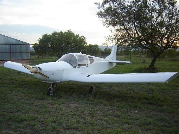

With the aircraft at the airfield...we could finally fit the wings!
WINGS FITTED
And impressed ....we are!!!

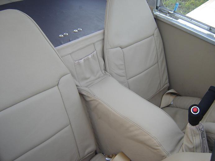

Now for some progress on the aircraft itself.

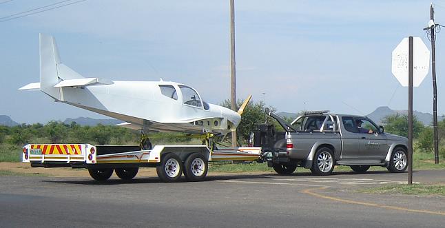

Then ...at last....it was time to get this aerie to FARG !!
WINGS FITTED

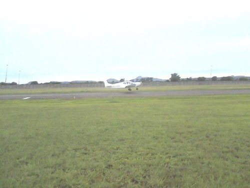

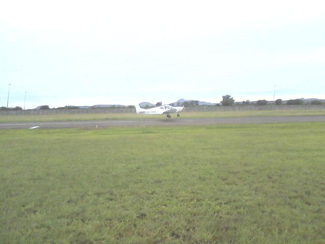

MAIDEN
FFZ took to the skies on 27 December 2009 !!!

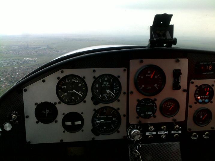

Beautiful! The aerie flies great - have good manners and predictable characteristics.
Here is an in-flight pic I took this morning
Its to early to tell what the real cruise speed and fuel burn will be.....but initial indicators looks good!
it looks like we'll be cruising at 85-90 MPH for now....burning around 15 l/h @ roughly 2700 RPM.
I'll post more data later (cruising speed & fuel burn at different RPM settings)
Stalls at 30MPH - power off - VERY docile!!
