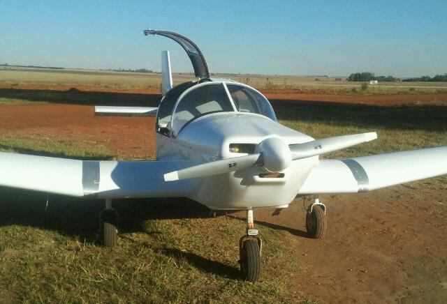

I have finally got the borrowed prop mounted, and it seems amazing. Static RPM up to 3050, and unloads to 3100 at 50kts. And performance seems great. Doing bunny hops down the runway, and landing back (never mind lifting off) at the intersection (around 350m).
But I have decided to ban myself from the cockpit until I am current again... My landings were not exactly pretty - the plane is rock solid in pitch, but twitchy in roll...
Test flight next weekend if everything works out!
Re: Justin's Raven
The cowling worked out well..looks good in the photo.
