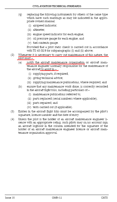

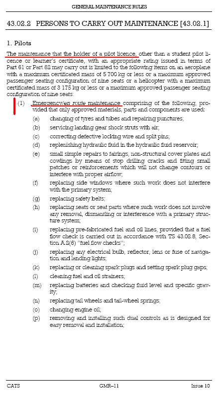

In Addition you need to read SECTON**2 with below: PART TECHNICAL STANDARDS - General Maintenance
I can see that I will be doing a lot of Emergency Maintenance come Jan 2008

Hi Rudi. Please explain what your interpretation is on these laws and why you quoted them here?
Remember that all laws are read together, and Part 24 only exempts Hang Gliders and Powered Paratrikes etc. from having approved maintenance schedules. Trikes HAVE to have one, and therefore we have to.
'Emergeny en-route maintenance' still has to be reported to an AME and you are limited to working on items as listed in the CATS. . Which AME will sign out work done without inspecting the aircraft / work. How does this affect the trike pilot in Springbok?
The paperwork trail for this new law is not in the interest of safety. How people will really record the serial number of each part you put on your aircraft? And why? They are not type certified, so nothing gets proven when they break... Except that insurance won't pay and CAA will fine you.
