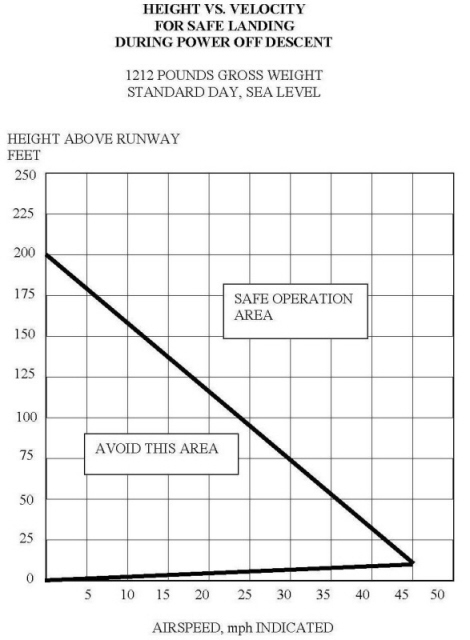

Just to refine the previous post, as per the attached graph, the height velocity graph shows the safe combinations of speed and height in a gyro. A similar, but more restrictive graph exists for helicopters as well.
If flying at 20 mph, at 100 feet AGL and below, and an engine failure occurs, the average gyro will end up landing very hard, with possible damage, and I would imagine spinal injuries would occur. A safer minimum speed at this low height would be around 40 mph. The higher one is, the safer it is to be at a low airspeed. Staying to the right of the solid line is considered safe in a gyro.
It is interesting that in the case of a Robinson R22 helicopter hovering at 500 feet and below, should he experience an engine failure, it is not enough height to lower the collective, in order to enter autorotation. In other words, a R22 should never hover below 500 feet (unles he is a couple of feet above the ground where a safe landing can be made).

We practice engine outs until it comes out our ears on both helicopters and gyro's! Once you're comfortable that you will be able to put it down in almost any small area, then flying becomes fun.
Interesting that a helicopter has a minimum height at higher speed which a gyro doesnt have. This is simply because the helicopter will descend while transitioning to autorotation which a gyro doesn't have to do. People glibly say, a gyro cannot stall, so big deal. Its exactly this fact that makes it the safest mode of flying. A fixed wing has to move through the air at just above its stallspeed on landing. Its slowing down that hurts you. Gyro's fuselage speed can be brought to a stop for a zero-roll on landing while the wing is still generating lift.
