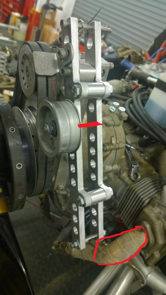

Hope us non technical n00bs can also learn from this thread (**)
Pity the pulley shaft cant go straight through to the other side for some extra strength (red line below). I assume the shaft will bump against the main structure and a bigger pulley wont fit between the other pulleys?
Also will the exhaust pipes be coated (Or is it already?) with that magical ceramic chrome looking stuff? Can't believe how well that works. 5 minutes after landing the pipes are ice cold.
