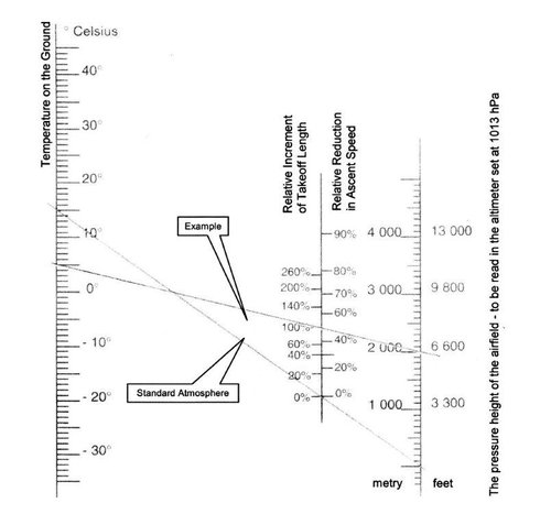

Len, I do have my own gyro performance chart that I compiled, tested and verified (via the MGL's black box data) that I use when not one up and close to MAUW. This chart is a simple DA calculator as well taking temp and altitude into consideration (with an average humidity). The chart then gives you the anticipated climb rate based on your weight and density altitude, but not your take-off run or distance to clear a 50ft obstacle, which I intend to add at a later stage.

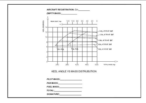

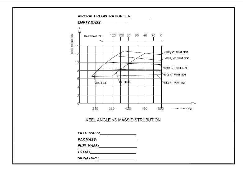

Morn Len & Marius,
This is where I get really excited, when the experienced Aviators start giving Air Polution like me your special tips! Len your chart seems to be 1 that is for a tandem, can it be used for a side by side, or do you need to adapt it in some way? Marius can we have more info on the chart you have developed, it will really help. Being a dumpling myself, a 90 kg pax and 60 lt fuel puts me on mauw already, so I tend to be very careful in doing these calcs. I use the chart in the Zen1 Flight Manual which I find very effective (I copied and laminated it and keep in map pouch in Gyro), weigh myself and pax on a simple bathroom scale in the hangar and calc fuel at 0.75kg/lt 95. I used the chart very effectively in Jan from FAKT with a pax that underestimated his weight by about 10 kg (no scale) and it was midday and 31 deg, so I was borderline left or right of mauw, and used 3/4 of FAKT 19 and had to start turning out left to clear the powerlines. Without consulting the chart I would have been in trouble. If I can have a mass&balance calc too, it will really help.

Just remember the attached chart is a rough guide for density altitude calculation, but should be within 200ft of correct density altitude, better than nothing.
A safety factor was built into the climb rate and I have found that it works / is the same for most gyros, or at least the ones I have flown. Climb rate was calculated @ 65-70Mph, not best angle of climb (again my own safety speed @ climb out after take off).
I would like you to test your performance against it at the above conditions and speeds and let me know.
Interesting that you mention the weight and balance. I obviously check my weight, but in the Xenon with all loading (additional luggage,etc) right under the mast I never thought of or experienced it to be a problem.
Sounds like you are describing your flight with me.PieterKotze wrote:from FAKT with a pax that underestimated his weight by about 10 kg (no scale) and it was midday and 31 deg, so I was borderline left or right of mauw, and used 3/4 of FAKT 19 and had to start turning out left to clear the powerlines.

Thanks Marius,
I will study the chart...very comprehensive! I must say, pax=85, me=110, 70 lt fuel gives me 560 kg and the density alt chart works to a T. Also I find my Gyro to be unbelieveable well balanced, with the trim setting on about 50 % straight and level is comfortable.
Thanks for the transfer of experience, much obliged.
Pieter
