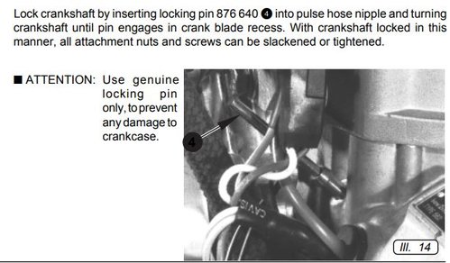

Dear Forumites
I need to lock the crankshaft of my old 582 silver top. The blue tops lock with a special bolt turned into the fuel pump pulse connector, not so the older ones. Any advice?

My apologies. The crankshaft is indeed locked through the pulse line nipple.
