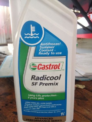

Good day guys. Time to renew coolant due to a radiator replacement. Can the guys that know give me the correct name of what to use available from Midas or the likes ?

Ready Cool from Castrol, comes in a GOLD coloured bottle, Mix 50 50 with distilled water. Only the best for your rotax!

Boet, I assume you mean Castrol Radicool SF ?Boet wrote:Ready Cool from Castrol, comes in a GOLD coloured bottle, Mix 50 50 with distilled water. Only the best for your rotax!

Castrol outboard mixed 50/50 with distilled water. It is worth the price.
Re: 582 coolant ?
Surely the Castrol premix should be fine ?John.com wrote:Make sure to get the 50/50 Prediluted Antifreeze & Coolant that is already pre-mixed with deionized water.
Re: 582 coolant ?
No problem RV.RV12 wrote:Surely the Castrol premix should be fine ?John.com wrote:Make sure to get the 50/50 Prediluted Antifreeze & Coolant that is already pre-mixed with deionized water.
